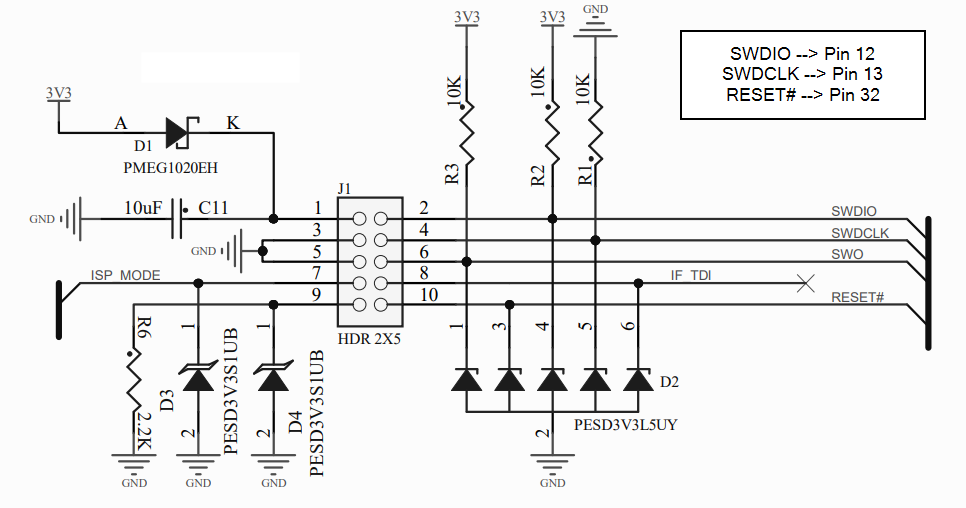

Hi, I am using the lpc5516 on a custom board, I am using the SWDIO pins to program my lpc5516 but I am only able to program once, after that I am not able to program again but my code is still working, I create my code using MCUXpresso configuration tools to configure my lpc to 150MHz, the code is working fine even if I am not able to reprogram it again, I tried to use ISP mode but I have not been successful, I can't reprogram.
The same code works well and can be reprogramed without problems in the evaluation board LPC55S16-EVK (Using LinkServer Debug), the only difference is the LPC55S16 that use the evaluation board with my LPC5516 and my programmer that is Multilink Universal FX.

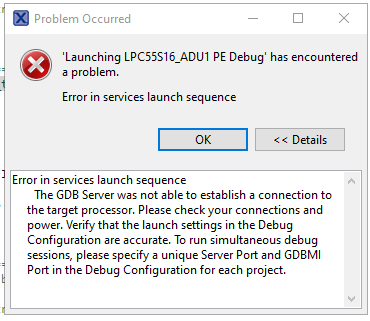

Can you give me some direction or some idea of ​​what might be happening?
If I change the microcontroller, it will be programmed only once or twice. The error that appears is:

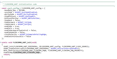

I programmed a simple example of an LED and I had no problems, when I programmed my code which was generated by MCUXpresso Config Tools is when I could not program again, doing tests I changed the micro and commented the FLEXCOMM0_UART_Init() function; after commenting it I have been able to reprogram many times, when uncommenting it and programming is when I can no longer program again. I try to enter ISP mode by pulling pin 88 to ground to try to program again but I have not been successful. Is it possible that a bad code blocks the reprogramming with my Universal Multilink? I have not moved registers corresponding to the debug or the SWDIO pins.
What I find strange is that even though I can't reprogram, the code works, that is, I can transmit at the baudrate I configured and I can receive the data in my interrupt, I used the oscilloscope to make sure that FLEXCOMM0 was working properly. I will configure everything without using MCUXpress Config tools and I will do some tests, maybe I have something wrong.
is there any way to recover my microcontroller? Even with pin 88 (ISP Mode) grounded i can't reprogram it again.

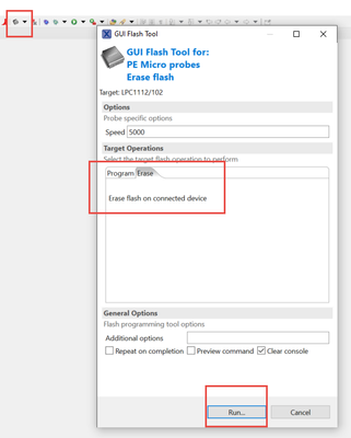

->>Yes, you can use ISP mode. It is no need any debugger in ISP mode. Just low the pin PIO0_5 (pin 88), then using UART or usb port to erase flash. The tool on PC you can use Flash Magic.
Another method is using MCUXpesso IDE, pressing ISP pin (pio0_5) when reset. Pay attention DO NOT release ISP pin.  Then using GUI Flash Tool inside MCUXpresso to erase.

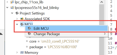

2> If you create a new project, please choose LPC5516. If you import a SDK demo for lpc55S16, you can try to change the chip to LPC5516 as below.
