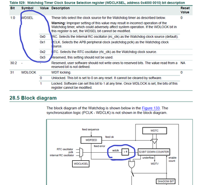

I am using LPC1768 watch dog timer, how can we determine to find out the Selectable time period  (TWDCLK × 232 × 4) and also  i configure mode register to enable the WDT. when we use the RESET bit in WDMOD.

From the following Figs, you can see that the WDT tick source can befrom irc_clk, PCLK and rtc_clk.
The nominal irc_clk is 4MHz , pls refer to section 4.3.1 Internal RC oscillator in UM10360.pdf
The rtc_clk is 1Hz which is generated by 32KHz crystal.
The PCLK for WDT is determined by the selection of register PCLKSEL0[PCLK_WDT], this is the setting, in other words:
PCLKSEL0[1:0]=00 in binary, CCLK/4 is selected.
PCLKSEL0[1:0]=01 in binary, CCLK is selected.
PCLKSEL0[1:0]=10 in binary, CCLK/2 is selected.
PCLKSEL0[1:0]=11 in binary, CCLK/8 is selected.
Pls refer to section 4.7.3 Peripheral Clock Selection registers 0 and 1 (PCLKSEL0 -
0x400F C1A8 and PCLKSEL1 - 0x400F C1AC)

For the CCLK frequency, pls refer to the PLL0 configuration and the post divider. Pls refer to Fig 7. Clock generation for the LPC176x/5x.
Hope it can help you
