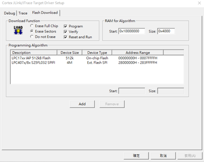

When executing the program for the first time, a complete burning program (CPU_FLASH+SPIFI_FLASH) is required.
As shown in the figure below.
SPIFI's flash is used to store some icons,Normally it will not be updated, but whenever I modify the content of the main program (in CPU_FLASH). I have to burn all the programs(CPU_FLASH+SPIFI_FLASH).it's a waste of time.

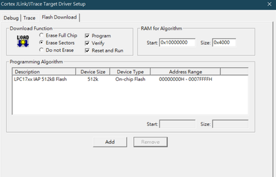

If I only burn the main program(As shown in the figure below),the program will not be executed correctly.
What I mean is, only burn the modified cpu flash, not the unmodified SPIFI FLASH, saving time.

You mean  the program spifi Flash the first time with IDE. This depends on IDE program algorithm and IDE option.
As far as I know, Keil doesn't have this feature you requested. Keil is not NXP product, you may consult Keil for more information. program algorithm is not recommended to be revised as well.
