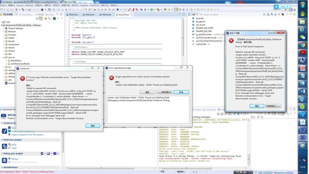

284286985
hi Jennie, thanks for your suggestion, please refer attached error report when begin download flash for debug .
please help have a check. thanks

284286985

ZhangJennie
So both MCUXpresso IDE and MDK can't connect the board. the problem may be more on HW than SW.

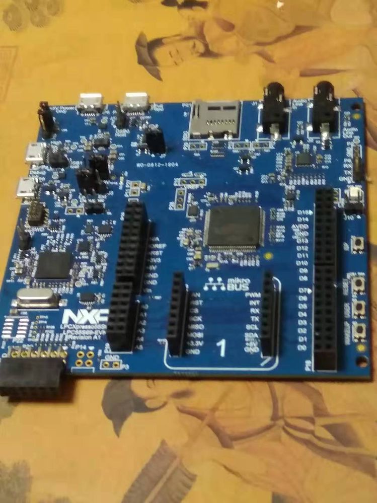

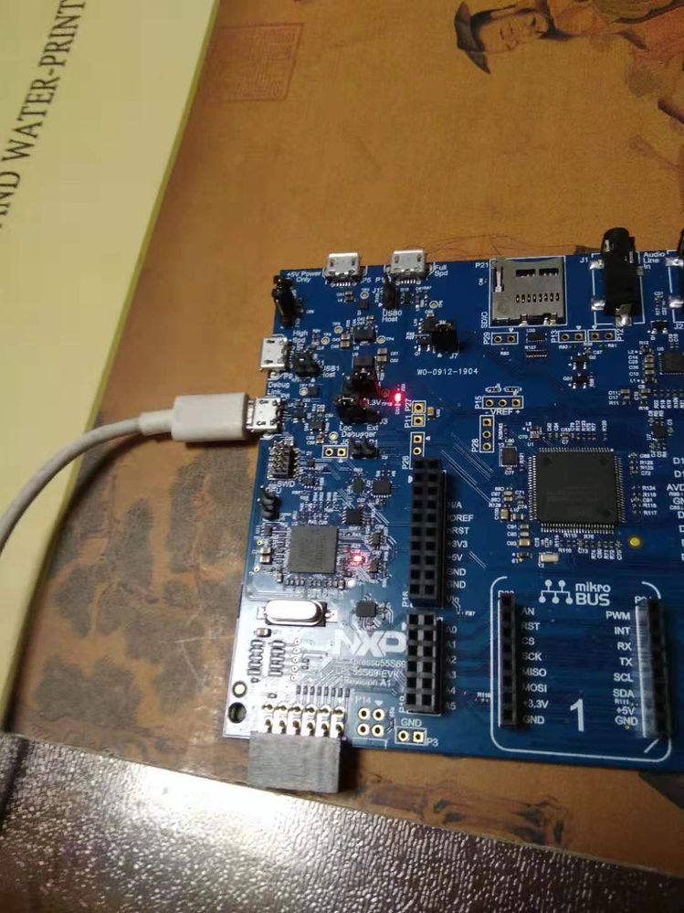

Please check if the problem is the same on another computer? if the problem is the same, send me a photo of the board WHEN BORD CONNECTING PC. let me check board status and connection.
Jun Zhang

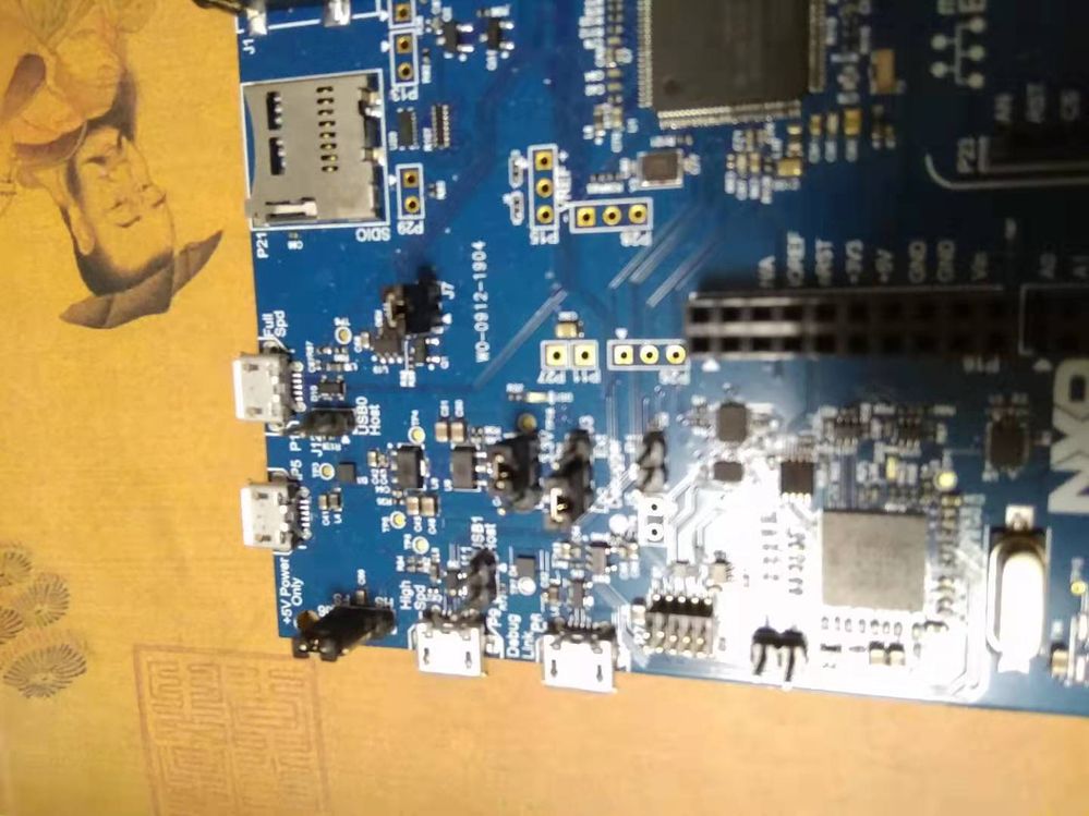

hi  jennie,
    I don't touch the switch since get the board,
   there is 4 switch in the board, for J6, select FS, for P4, select 3.3v, for J3, select "loc"  and J4 is connect.

ZhangJennie
Rike,
I checked your board, the jumpers and leds status are ok.

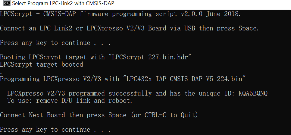

I suggest you update the on board debugger firmware with LPCScrypt.
LPCScrypt v2.1.0 | NXP
!! Don't forget install DFU(J4) during the update, and remove it after.
You should be able to see below message if the DFU update successful.
!! make sure you have checked the board with two more computer. If you finish all above checking but still have problem, please go to the distributor whom you bought board from and check if your board is not broken.
