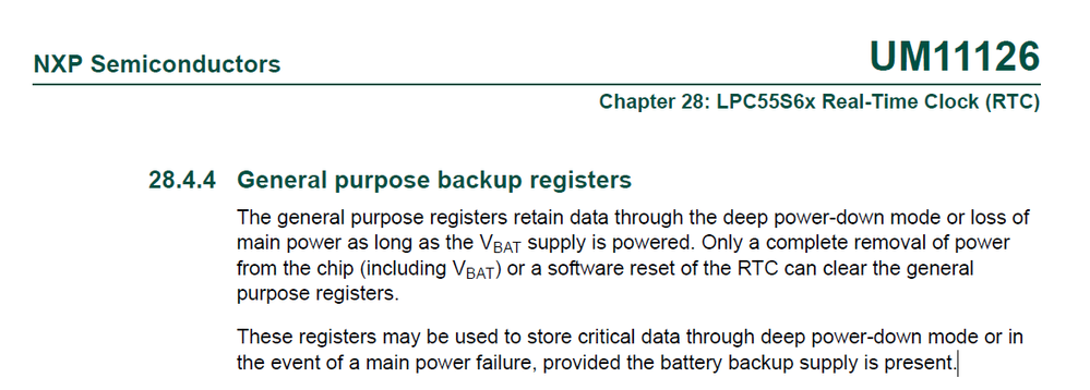

Yes it is no need for normal MCU usage. But for example K82 MCU have VBAT register file what retain context over reboot. It is very useful feature if you need to reboot MCU and would like to save some states in SRAM.
Is LPC55x have this kind of SRAM area ?

xiangjun_rong
Hi, Eugene,
Regarding your question, the LPC55S6x has the similar registers in RTC module, which is powered by the VBAT pin. If the main power is down, but the VBAT pin is powered, the data in the registers retain.
The registers are called "RTC general purpose registers 0 to 7 (GPREG[0:7], offset 0x40:0x5C)"
Hope it can help you
XiangJun Rong
