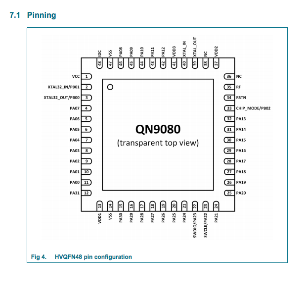

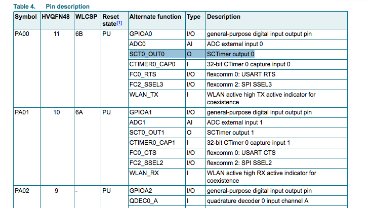

I am trying to use the GPIO to control a tricolor LED.
As I am using SCTimer for PWM control, I need the pin table that specifies the pin/port for each SCTimer output.
Something similar to this
Screen Shot 2018-10-10 at 2.50.58 PM.pngScreen Shot 2018-10-10 at 2.51.11 PM.png
Unfortunately such information is not included in the user manual.
Where can I find such a pin table for UM11079 IoT Module Base Board?
