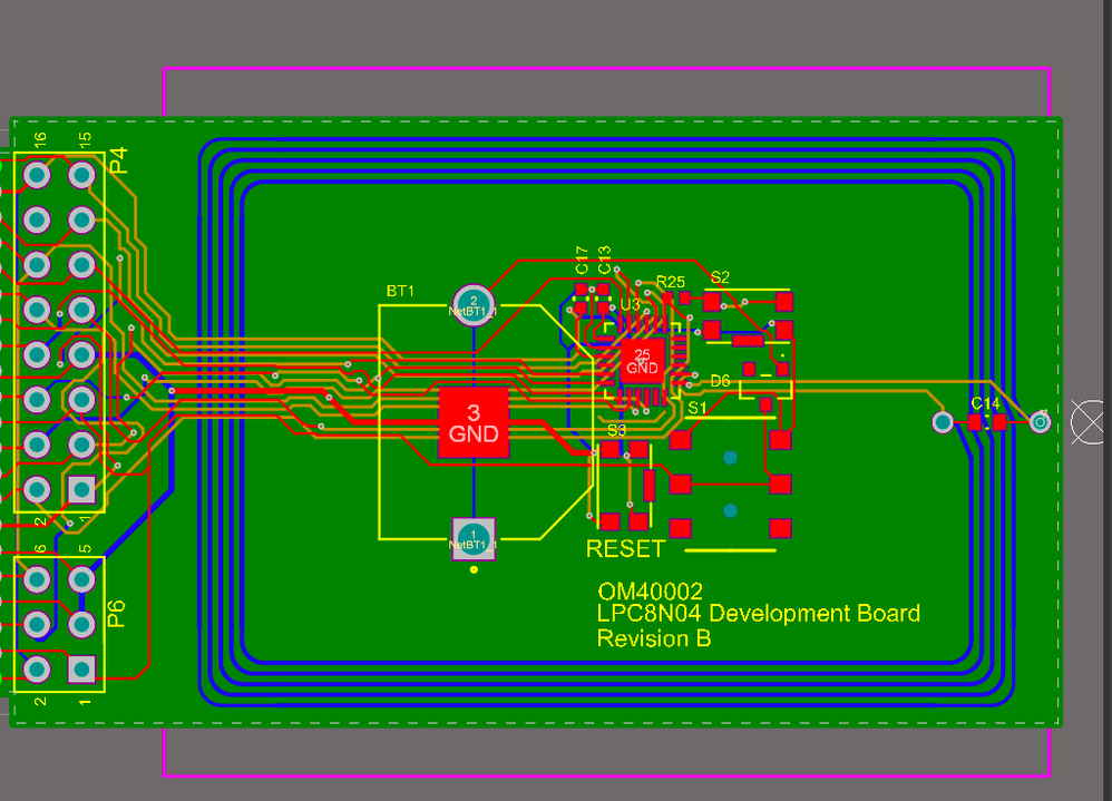

Where can I download the latest Rev C board design files for the OM40002 / LPC8N04 development board?
The LPC8N04 development board page here currently has board design files for Revision B.
The current dev boards shipping are Revision C.
Are any notes available on what was changed aside form the coincell?

The Rev change to C from B, main reason is the 8N04 chip is different, the 8N04 chip on RevC with OTA function, while RevB without.
The design files for RevB and RevC is almost same, only some component name and value get a little bit change,
such as XC6227 change to XC6206, LED APHD1608LCGCK change to OSRAM LY L29K, LED RES: R26,27,29,32,36,37,38 value change to 51ohm.
only speaker circuit get some change, but function is same.
So you can use the RevB design files for RevC board with no problem. Thanks.

Thanks Alice_Yang‌! This works for our needs! I'm sure others would appreciate it if NXP can release the updated board files on their website soon but we can make do with this!
