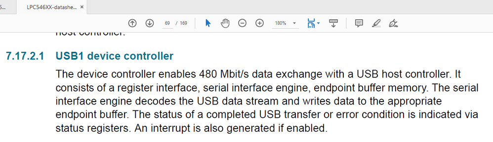

ZhangJennie
Hi will hunt
According to LPC546xx datasheet, USB1 speed can reach 480Mbit/s.
