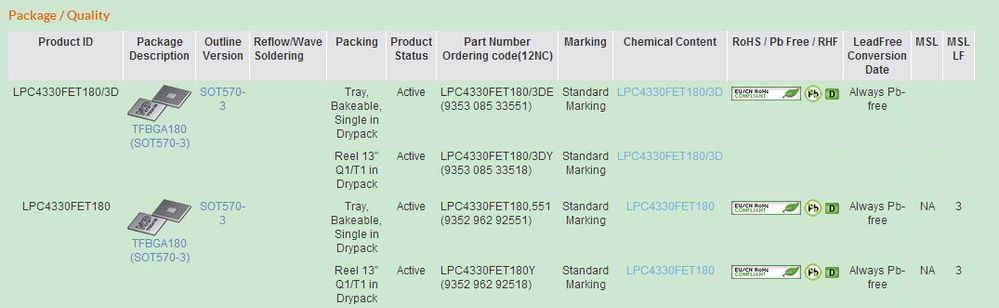

What are the difference between part numbers LPC4330FET180,551, LPC4330FET180/3D and LPC4330FET180Y ?

They are the unique, complete order number for the devices and the order number also includes the packing information.
