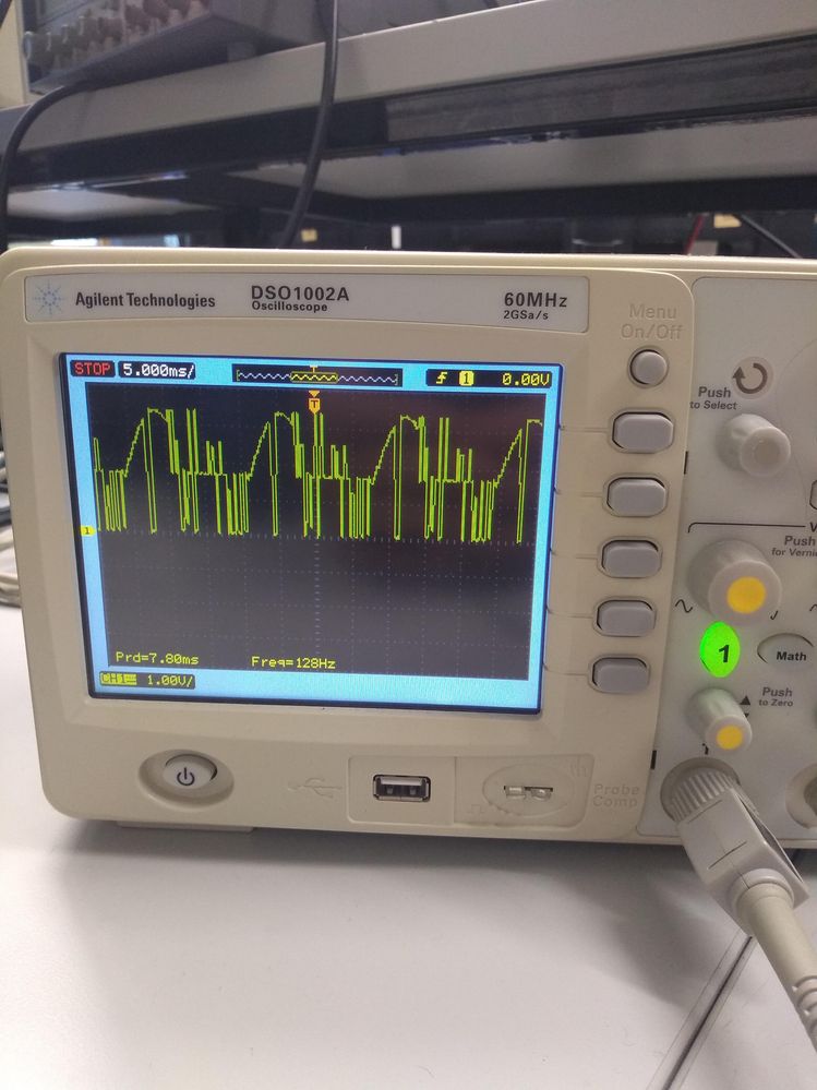

Hi There,
I'm trying to create a function generator using the DMA mem-to-peripheral transfer controller. I wrote some code to test the DMA to DAC functionality and it worked perfectly, producing a lovely and clean sine wave:

The next logical step was to extract the DMA initialisation into a function, which accepts a pointer to the data to pass. Using the exact same configuration options, instead passing them through a function I got nothing on the analogue output. I am generating the sine LUT in main still. I had a feeling it would be due to some weird scope issues, because when I moved the LUT generating code into the GPDMA function I got a sinewave on the out, albeit a very noisy one. So I changed the GPDMA lib to take a function that generates the LUT:

void gpdma_dac_func_config(uint32_t (*func)(uint32_t), uint32_t size, uint32_t freq, uint32_t repeat) {

This produces the same noisy sine wave before. As you can see it looks like only parts of the memory are being transferred properly. Is this something to do with function scope or memory that I don't understand. Should I be initialising the LUT somewhere else? Bare in mind that when I just passed a pointer to the LUT (genned in main) to gpdma_dac_config(), the output was a constant zero. Maybe it is optimised out?IMG_20191118_154642186.jpg
I'm at a real loss with this one. I'm not really sure how to debug it either. Can you get a memory dump, so I can verify the integrity of the LUT?
Any help would be much appreciated!
Many thanks,
Rory

Okay so initialising the variables from within the function seemed to be an issue.
void gpdma_config(uint32_t* source, uint16_t size, GPDMA_LLI_Type* LLI, GPDMA_Channel_CFG_Type* dma_cfg) {

This works fine, but you have to declare your dma cfg structs in the main, which feels messy. I would really like to know why this is the case. As far as I understand function scopes there really shouldn't be an issue here.
