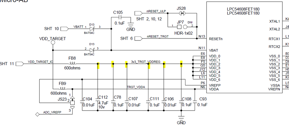

VDD decoupling capacitors, according to the datasheet:
"Position the decoupling capacitors of 0.1 μF and 0.01 μF as close as possible to the VDD pin. Add one set of decoupling capacitors to each VDD pin.:
This means at least 1+12 = total 13 capacitors!
In the EVB there are 1x 4.7uF and 5x0.1uF total 6 capacitors.
Should I follow the DS or there is some flexibility here?
BR,
Liron

Omar_Anguiano
Hello Liron Homsky
I suggest you refer the schematic of the EVB with 4.7uF, 0.1uF, and 0.1uF capacitors. The values from the datasheet could be an option but I suggest the values from the EVB schematic.
Let me know if this is helpful if you have more questions do not hesitate to ask me
