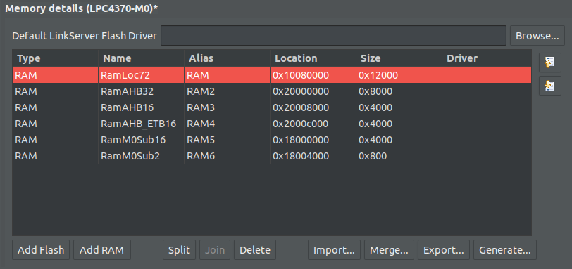

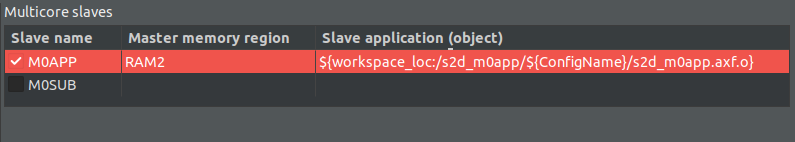

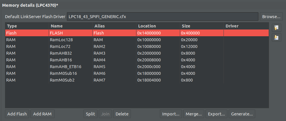

I'm on a journey to implement a multicore application on the LPC4370.
I'm trying to lay the basis and understand multicore projects and how to debug hem before adding stuff.
At the moment I created a M4+M0app project.
Memory configuration for M4:
The M4 core executes code from FLASH, while the M0app from RAM2:
Memory configuration for M0:
The problem is that I can't debug the projects successfully:
  • Can stop the M4, but not set breakpoints
  • Can not interact with M0 (leads to "failed to execute MI command -exec-interrupt").
    Here's a video where I show a session of debug. Note that I am using LPClink2 and it is working as I can correctly debug other single core projects.

converse
Senior Contributor V
Did you follow this guide
LPC43xx Cortex-M4 / M0 Multicore Applications
There is also a workshop here:
https://community.nxp.com/docs/DOC-331545
(Debugging starts at slide 79)
