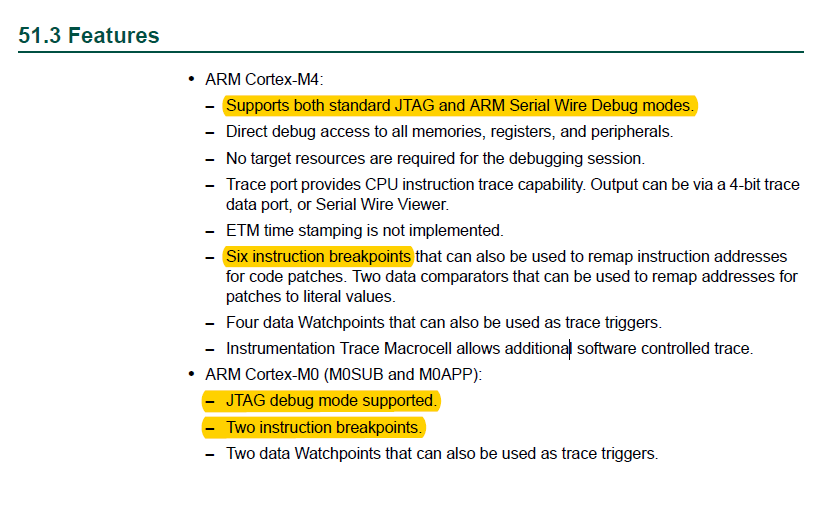

kerryzhou
Hi nos1989,
    Debug breakpoint is no relationship with freertos.
   The ARM Cortex-M0 in LPC4357 can support 2 instruction breakpoints, but you need to use JTAG debug mode.
   You can find this information in the LPC4357 user manual:
Please check your debug interface, and try again.
If you still have question, please tell me the detail step how reflect your problem, I will test it on my side.
