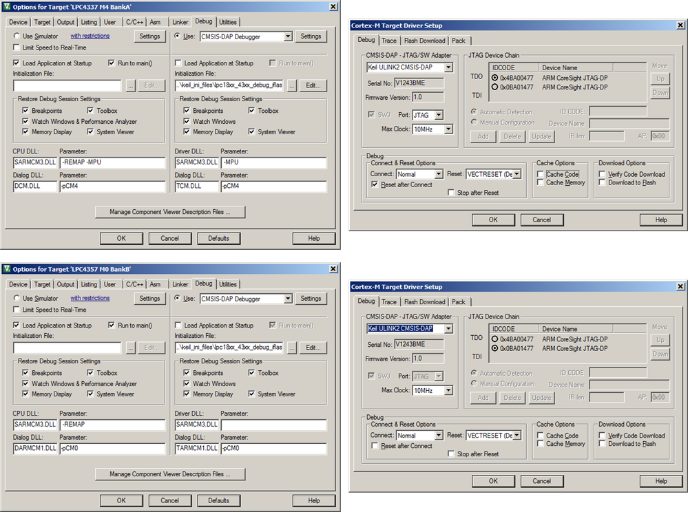

bernhardfink
In the CM0 project there was no INI file provided for the debugger start. This means that the debug information from the axf file was not loaded into the debugger, therefore the relation between the source code and the binary code was missing. Anyway, it is indeed possible to set breakpoints, but just in the assembler code window.
Take the attached complete setup or do it simply by yourself, just provide the same ini file for both debug setups:
Bernhard.

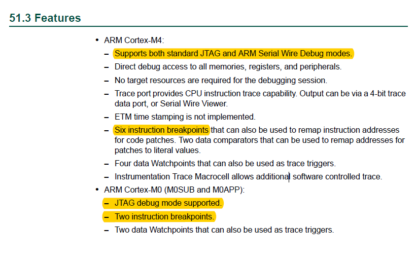

   The ARM Cortex-M0 in LPC4357 can support 2 instruction breakpoints, but you need to use JTAG debug mode.
   You can find this information in the LPC4357 user manual:
Please check your debug interface, and try again.

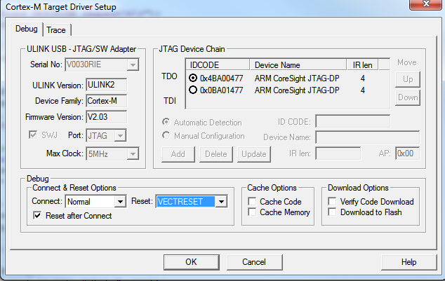

Thank you for your reply.  I wasn't working on this project for a little bit, but now just resumed.  I am still unable to hit any breakpoints on the M0 core.  Again, I know that specific code is executing, because I have some debug messages in that location, outputting to a serial console. The debugger is set to JTAG mode, here's what I have for settings:
Thanks in advanced for the help.

bernhardfink
Bernhard.

fernandotheirs
Thank you very much! That was the problem!! :smileygrin:
