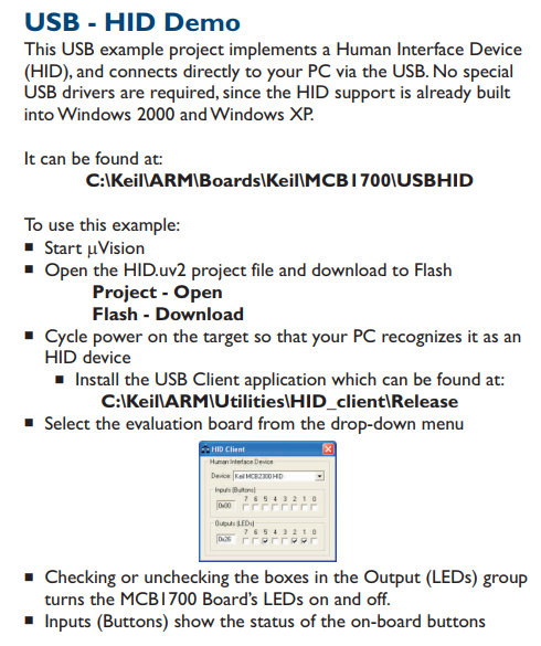

Hui_Ma
Hi Alan,
First of all, sorry for the later reply.
Unfortunately, there without related application note about USB device [bandwidth test] demo project.
There using four endpoints at [bwtest] demo.
If you check here you could found Keil provide USB Stack for MCB4300(LPC4357) board.
There with PC host HID application located at Keil installation folder <HIDClient.exe>.
The related source code also at that folder.
More detailed info, please check below picture:
Wish it helps.
Mike
