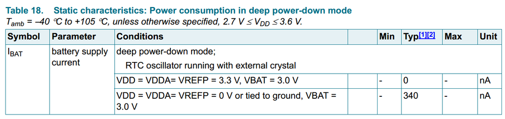

We designed a board with LPC54606J512.The VBAT pin was supplied by one rechargeable lithium battery,so when the board is powered down,the VBAT is still powered on and other power pins are powered down.The lithium battery's capacity is 5.5mAh.But we found the VBAT was powered down in 2 weeks board testing.I tested the VDD pin's voltage was about 0.9V while the VBAT was 2.8V.The VDD is designed 2.8V and the lithium battery is charged when the board is powered on.
So I want to ask what's the VBAT current consumption in my board when powered down? I found table 18 in UM10912 but I doubt my board's VBAT current consumption.

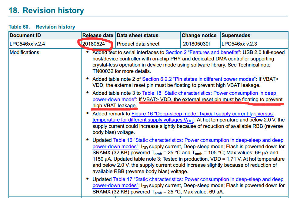

Thanks for your reply.
After I removed the resistor pulled the RESET pin up to VDD,the VDD was 0V and the VBAT current was less than 1uA when the board was powered down while the VBAT was 2.8V.The problem was sovled.But I found the sentence"If VBAT> VDD, the external reset pin must be floating to prevent high VBAT leakage."was added in datasheet revision v.2.4 that release date 20180524.So I wonder if my question caused the release?revision history.png

sergedemaseneer
I don't know if it is of any value but i found this in the data sheet page 92:
[3] If VBAT> VDD, the external reset pin must be floating to prevent high VBAT leakage
So what is the state of this external reset pin when VDD is switched off?

The VBAT current  I tested when board was powered down was 19uA! Is this normal?

jeremyzhou
I'd like to know whether the MCU enter some low power mode after the MCU is supplied by lithium battery.
If not, the above screenshot is not in accord with your implementation.

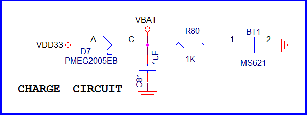

jeremyzhou
the opportunity to serve you.
I was wondering if you can share the schematic of your aboard, as I'd like to know how you design the VBAT supply circuit.

wangchunzhongwa
The VDD33 was generated by one DC-DC power supply.The VBAT was directly connected to the VBAT pin of LPC54606.
