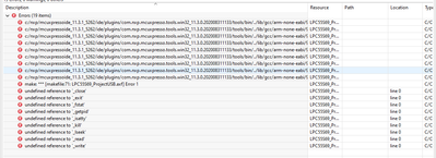

MattT
which flags do you use to compile it with "NewLib (none)". If i create a fresh project i run into following errors:
I am using for my project "NewLib (nohost)"

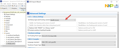

ZhangJennie
I use NewLib (none)
Try import a usb demo, during import, select NewLib (none) as my screenshot. See if this works for you?

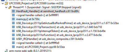

I found out that the memcpy causes a unaligned memory addess.

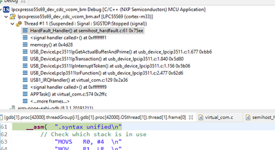

13,853 Views
MattT
Here the current varibles:
