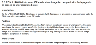

Hello @WilliamW
This is stated in errata:
After testing and confirming with the ROM team, only a full error CRC image will enter ISP mode after a failed boot(for example, you can modify the last few bytes of the CRC image for testing.). When the header of the firmware is valid but the remaining part of the flash is erased, the boot fails but does not enter ISP mode.
This issue should be fixed on latest devices, I have test on date code 23111B LPC55S69 devices(I don't have LPC55S28 on my hand), this feature works well as expected.
Alice

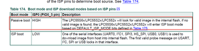

Hello @WilliamW
Theoretically, when ISP0 pin is high. If no valid  image is found, the LPC55s28 will enter ISP boot mode based on DEFAULT_ISP_MODE bits defined.
Do you update image with Plain CRC Image type?  What Image type was it before update?
After removing power while updating, it did not enter ISP mode after power again?
