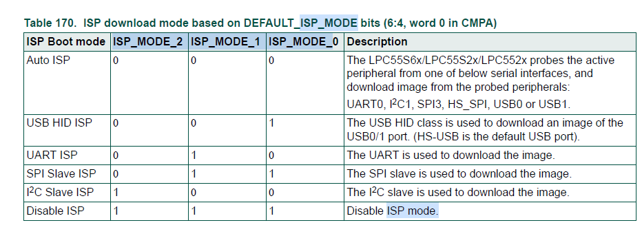

Hello Mike,
-There isn't USB DFU demo under LPC55sxx. There is usb_device_dfu demo under MCUXpresso SDK for LPC54608,
you can have a look.
-And if you just want to update image, you can also make your chip enter into ISP mode, then can through USB , UART or other interface to program, about detail please refer to UM:
-There is a second bootloader , you can have a look, it for lpc55s69.
https://www.nxp.com/docs/en/application-note/AN12327.pdf
