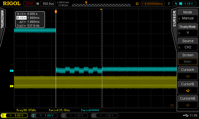

I am realising ISO7816-3 SmartCard interface with level translator. I am using MCU LPC54608 and TXB0104 as level translator. Power level on smart card - 3.0V (Class B), voltage level on MCU - 3.3V. In future also need support Class A (5.0V) and Class C (1.8V). In MCU side I/O pin have pull-up resistor 100k, in SmartCard side pull-up 100k too.
I correct receive ATR, oscillograme of it (clock frequency 2MHz):

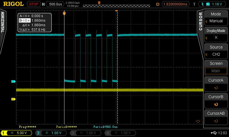

But, if I try to send data to interface, I see this (data byte 0xAA):
I see, that data transmited, but translator switch from 1 to 0 and locked in this state.

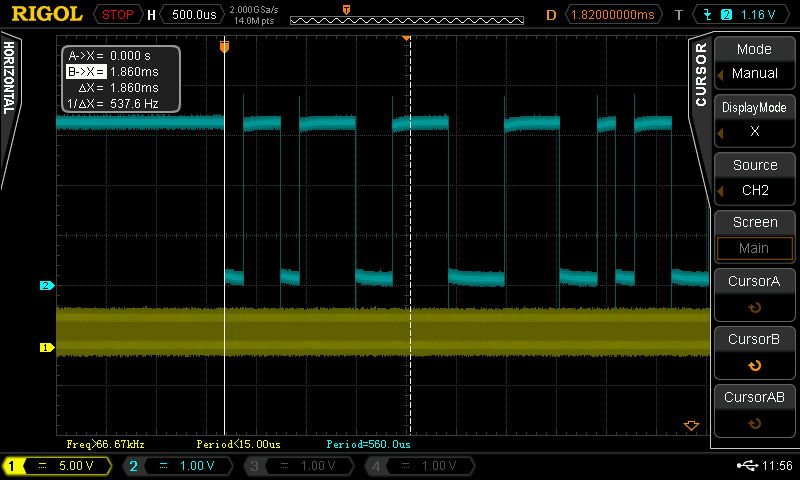

If I didn't setup "Smart Card Interface Enable" bit in SCICTRL register, I have this oscillograme:
Thus levels sets ok.

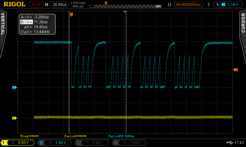

Without TXB0104 and speed setup TA=0x96 (clock frequency 5MHz, etu value is 16) and pull up 100k, I have this oscillograme on transmit:
This confirms, that IO pin work in Open-Drain mode.

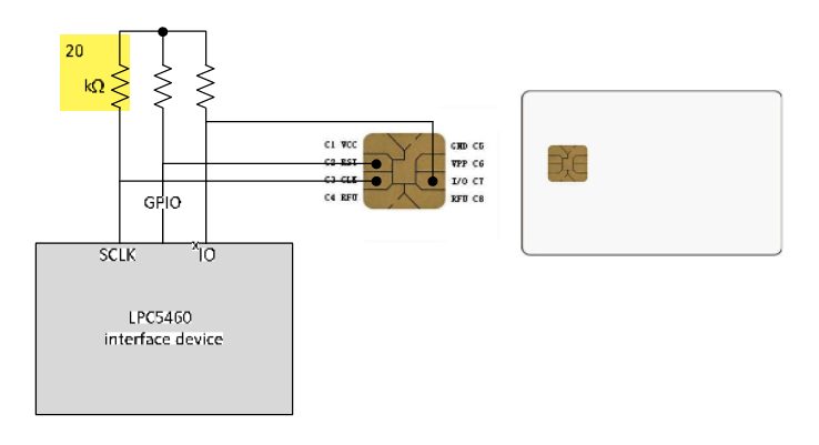

FelipeGarcia
Please check below image, 20 Kohm resistors are recommended. For push-pull output you can change OD bit in IOCON registers. Here you will change pen-drain output or push-pull output.
Regarding the level translator, I am not expert in this matter so I recommend you to create a different question with a detail description in the community space below.

In You picture 20k pull-up sets on SCLK. My question about SCIO-line.
