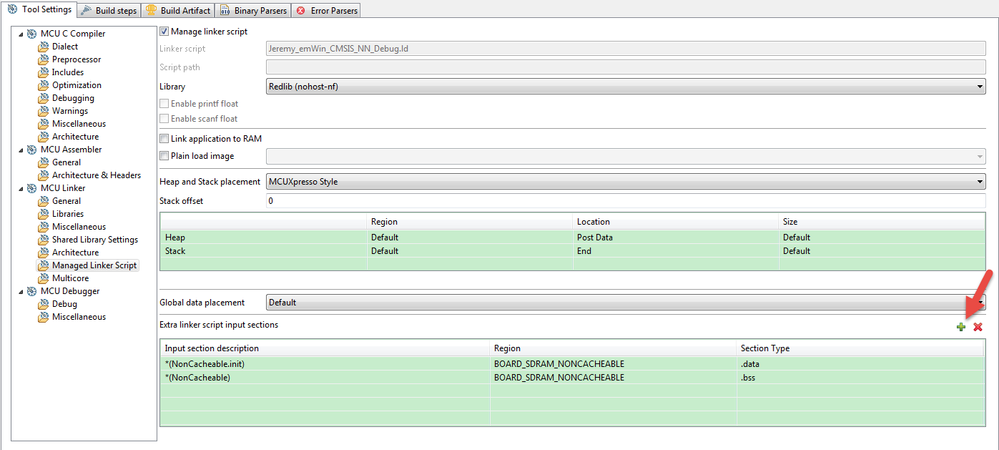

-- I mean that the MCUXpresso IDE has provided the friendly button, the developer follows it can make it quickly, just like the below figure presents that click plus to adding some extra linker section.

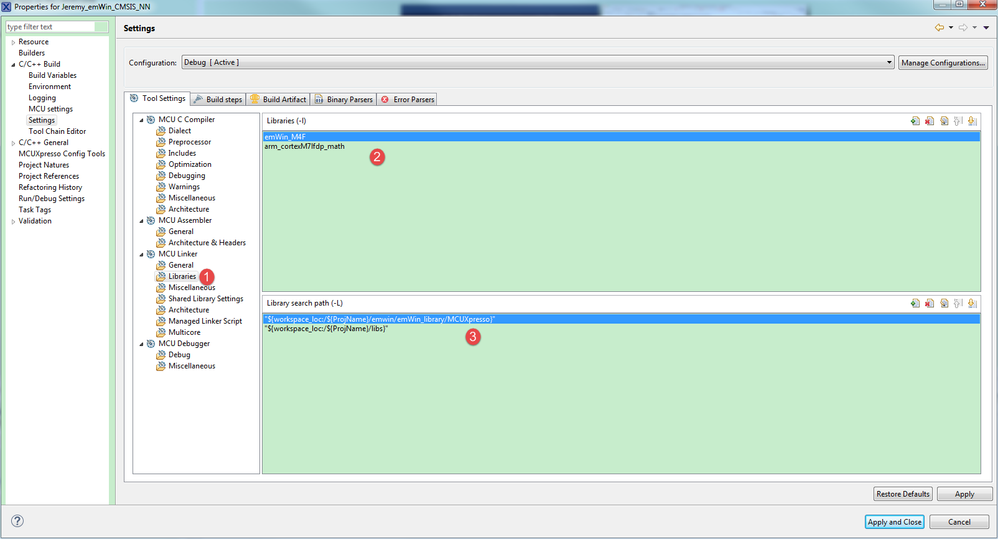

2) The below presents how to add the library into a demo project in the MCUXpresso IDE.

BillTheBiker
So to be clear you create a section description and point to extended flash (flash2) and then you create the library and add to the project (your second slide) and then this library is now located into flash2?  I do not see the linkage here!  I have no problem referencing libraries in my project, my question is how can I direct the output of the compile (the .a file) such that the linker places into extended flash.  Basically I want to create a library (pre-compiled to get the .a file), drop the .a file into the project, create the references to the library and then tell the linker to place this .a file into the spiffy flash.  Is this possible (and no cr_section_macros.h is not the answer for large 3rd party source)

jeremyzhou
Hi ,
Thanks for your reply.
It needs to use own linker file which uses the command to add the library object like the post shows.
In further, please refer to the post to learn how to create own linker file.
