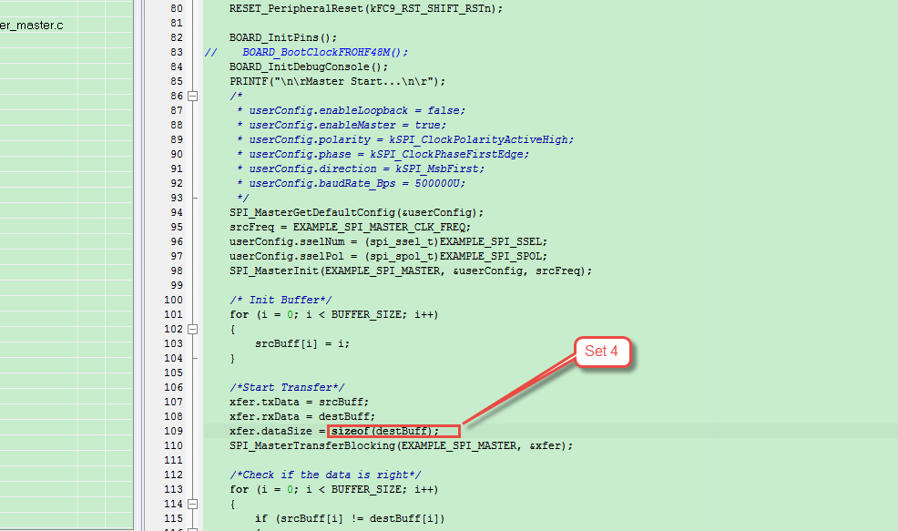

I would like to transfer(write and then read the response from slave), the format is both 4-byte.
Is it correct to exchange "uint8_t srcBuff" to "uint32_t srcBuff"?
Should I change the "uint8_t *txData, *rxData" from function SPI_MasterTransferBlocking?
If my polling period is 10 mSec, how to adjust from the example code?

Hi YuChia Chien,
    Next time, when you create the question, please also share the LPC chip partnumber you are using, and tell us the code source.
   It seems you are using the LPC5460X, and the SDK code for LPC5460X.
   1. 4 byte data transfer
     No, you don't need to modify the unit8_t to uint32, please modify the dataSize to 4, like the following picture:
2. If my polling period is 10 mSec, how to adjust from the example code?
I can't totally understand your question.
What do you mean the 10ms period, do you want to change the SPI baud rate?
If you want to change the SPI baudrate, you can change     config->baudRate_Bps = 500000U; in function void SPI_MasterGetDefaultConfig(spi_master_config_t *config).
Wish it helps you~!
Kerry

larry781111
Hi Kerry,
Thanks your reply.
My chip is LPC51U68 and I use on OM40005.
1. For the first question, I need to transfer 4-byte data in a time. The actual value is 0x80000000.
How to assign the value to srcBuff.
2. What I mean is that after Master transfer the value 0x80000000, need to wait 10 msec then receive the  response from slave.
2,748件の閲覧回数
kerryzhou
Hi YuChia,
  You can assign the value to srcBuff like this:
srcBuff[0]=0x80;
srcBuff[1]=0x00;
srcBuff[2]=0x00;
srcBuff[3]=0x00;
or you also can define srcBuff as unint32, then set srcBuff[0]=0x80000000; but the dataSize need to be 4,
SPI have MISO, MOSI, when you send the data to MOSI, the input data will enter the MISO at the same time, so you don't need to wait 10msec, otherwise your receive is in the next SPI frame.
Kerry
