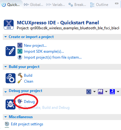

Hello Ashkan, I hope you're doing well,
Could you please try clicking on the Boot Debug Probe button and after that clicking on the Debug button on the Quickstart panel:
Please let me know if that works.
Sebastian
19,986件の閲覧回数
ashkanrezaee
HiSebastian,
I got same error:

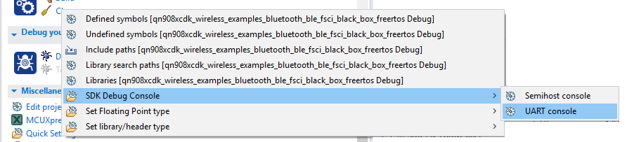

Hello Ashkan,
Could you please tell me what version of the board you're using?
Also, did you set the debug console to UART instead of Semihosting? You can set this after creating your project by clicking on the "Quick Settings" button and setting the SDK debug console to "UART console":
If that still doesn't work, could you please check these other two threads (here and here) on how to recover your QN9080 Development Kit?
Sebastian
19,986件の閲覧回数
ashkanrezaee
Hi Sebastian,
my board version is QN9080 DK-V1.2.
Semihost or UART doesn't change any difference. both of them gave me the same error.
