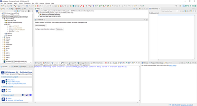

We are working on a project where we have been doing our development on LPCXpresso54018 eval board.  Yesterday we got in our custom PCBs which use the LPCXpresso54018 as a reference design (same external flash, same SDRAM, same LCD) however our custom PCB uses the *208 package.  I attempted to run some of the basic SDK example programs (hello_world, gpio_led_output) on our custom PCB after changing Project Settings>MCU>package to match our part but so far have failed to get any of those to run.  I can only successfully run code on our custom PCB if I use create a New Project and have the *208 selected from the start.
Are there step by step directions available for how to successfully modify an SDK example program so that it can run on the LPC54018JBD208?  Thanks.

I once again tried to start from a simple SDK example (drivers->gpio_led_output) and then make all of the necessary changes (package, pin configuration) to match our processor.  I am still having the same result of not being able to successfully run the code on the processor.  Here is an example message that I get after running Debug:
"Break at address "0x300084c" with no debug information available, or outside of program code."
I feel like there must be one other location where a change needs to be made that is missing.

I get the error after launching Debug.  It goes through the initial process but then there is never an option to Resume or Step through any code.  Below I will show a screenshot of what appears in the IDE after pressing Debug and also I will paste the Console Debug messages.

4,551件の閲覧回数
mitchkapa
We have an update to this problem.  It appears to specifically be a problem with the SDK_2.xLPCXpresso54018 (installed version 2.8.2).  If I select examples from SDK_2.x_LPCXpresso54S018 (installed version 2.11.1) I can successfully import SDK examples and change the processor package and run those examples on our custom hardware.  For our project this is an acceptable solution.

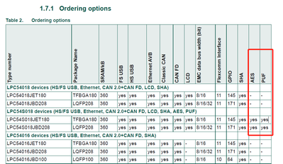

Is the "non-S" SDK considered to be an older package than the S version?  I have been viewing both SDKs as separate and valid.  If that is not the case I think there should be some messaging or documentation to help make sure that people end up with the "S" version of the SDK.  Otherwise I think people like myself who purchase the LPCXpresso54018 development board end up with the "non-S" SDK by default.
4,504件の閲覧回数
ZhangJennie
Do you mean SDK for LPC54018 and LPC54S018?
These are two parts, not related with old or new.
S version has security feature while non-S doesn't. besides this feature, others are the same.LPC54018 can run on LPC54S018 without issue.
