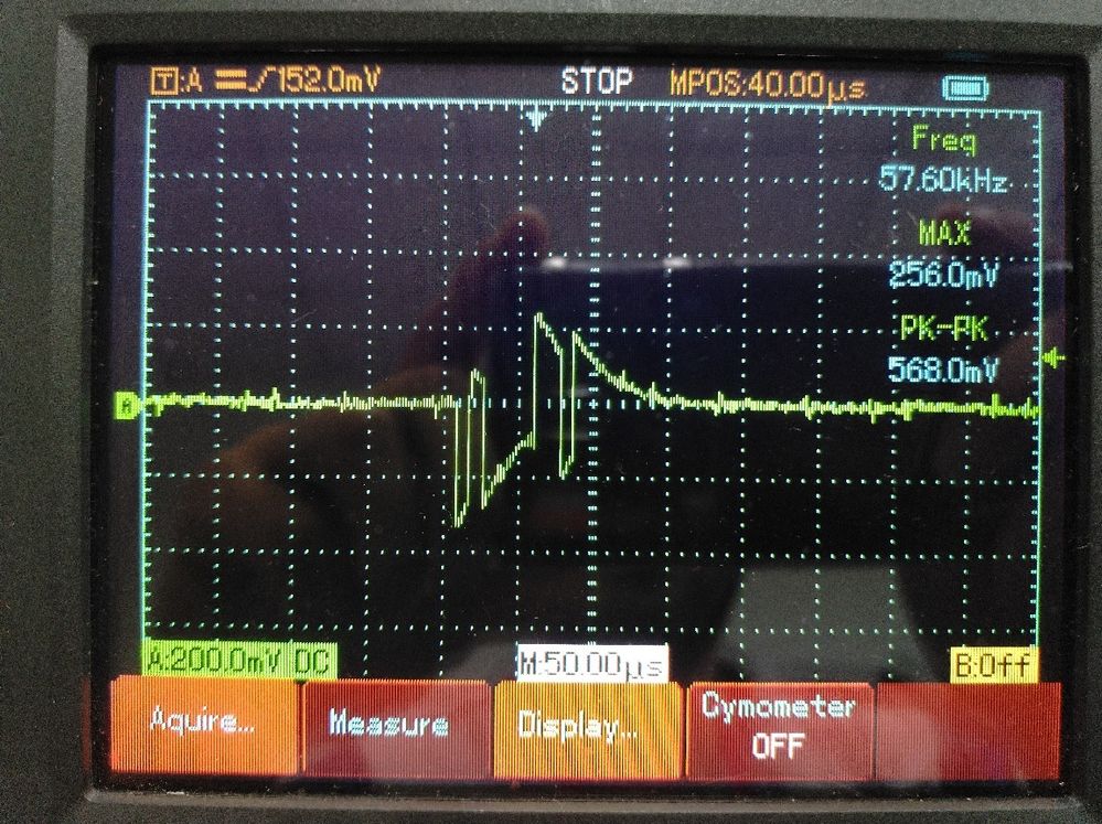

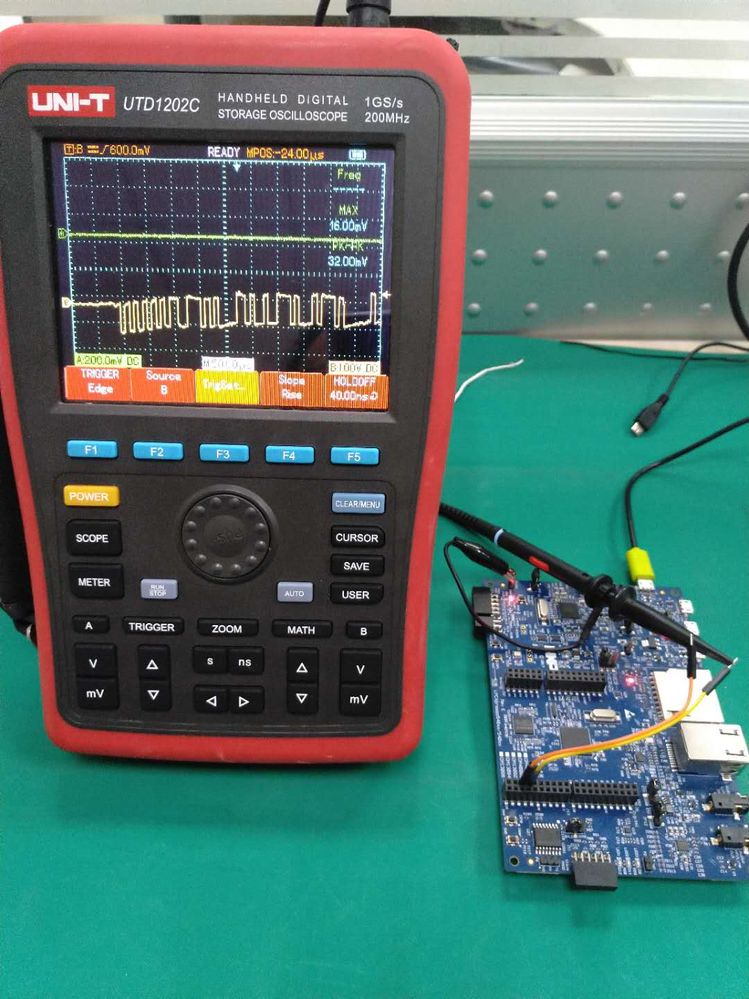

After I adapted the basic Uart Polling echo demo to use UART4 (FlexComm4) from J13 pin 13/15 (TX/RX) [lpc pin 3_26/ pin3_27]. No problem for the UART to receive data from a USB-RS232_0V converter and using TeraTerm. But here i'm facing a issue for the TX. Every data is not well displayed by TeraTerm, so I decided modify code to send only character "a" and check signal on J13 pin 15.
In picture in attachment, signal is +/-250mV ?! I don't unsterdand why. It should be between 0V and +5V. Code in attachment

Hi arecz,
   Your oscilloscope is really very special, do you have any other oscilloscope ?
   Can you try another oscilloscope? Take an example Tektronix.
    I never used the Hand oscilloscope like your type.
Kerry

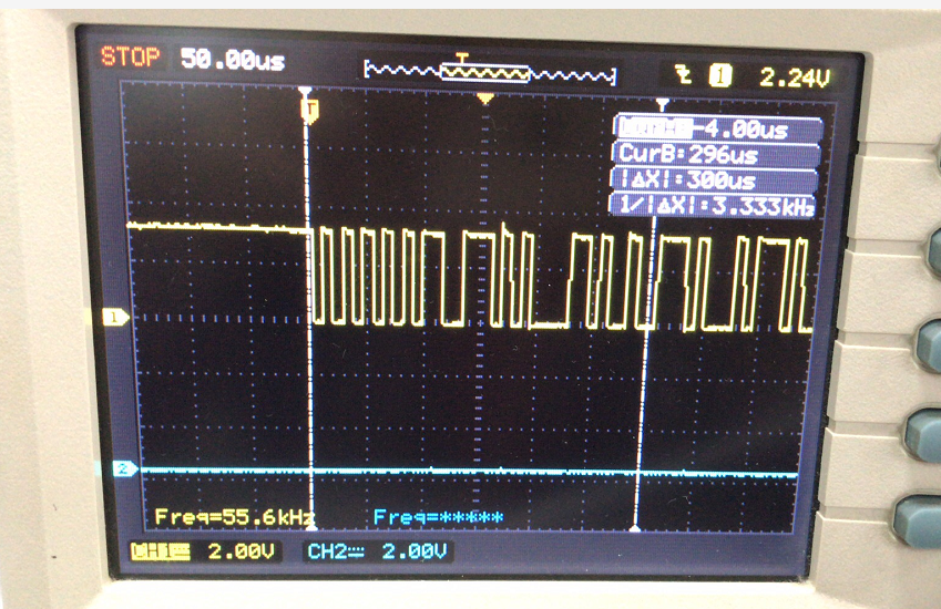

This is my test wave:
Yellow:  LPC54628 RX
Blue: lpc54628 TX
Please also check my attached code:

arecz
Hi. This is my TX signal. No connection to my TTL-USB tool. My LPC54628 is powered by USB connected to a computer dock station.
10,172 Views
kerryzhou
Hi arecz,
   Check your Oscillator, do you connect the GND to the board?
   This wave is very strange.
   It seems the oscilloscope GND is not stable.
    Can you change another Channel?
  GND you can use P3.
Kerry

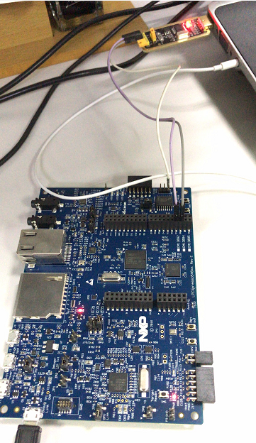

arecz
Hi Kerry,
This is my set. Change to channel B on scope. Ground from P3.
I tried with Flexcomm4, Flexcomm9 (from Slave PMOD output) and Flexcomm0. Always same result...
When I tried Flexcomm0 on P4, I connected JP6 as described in user manual but nothing changed.

kerryzhou
Hi arecz,
Kerry
10,173 Views
arecz
I will buy new one.
I will let you now when i'm ready again.
Thanks for you help.

arecz
Hi Kerry,
So I had checked signal with a good scope. All signals were fine. So I decided to change my USB tool. I just receive it and try with it. The NXP demo are working well now.
Thank you for your support.
10,173 Views
kerryzhou
Hi Arecz,
     That't very happy to hear you get the good wave now.
     Actually, after I check your scope picture, I am suspect your oscilloscope, I don't believe the Hand oscilloscope tool.
     If you still have question about this topic, please kindly let me know.

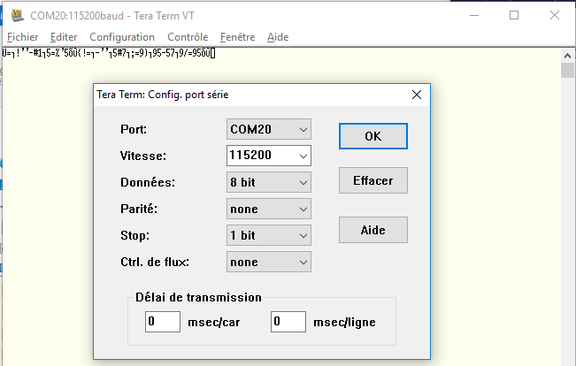

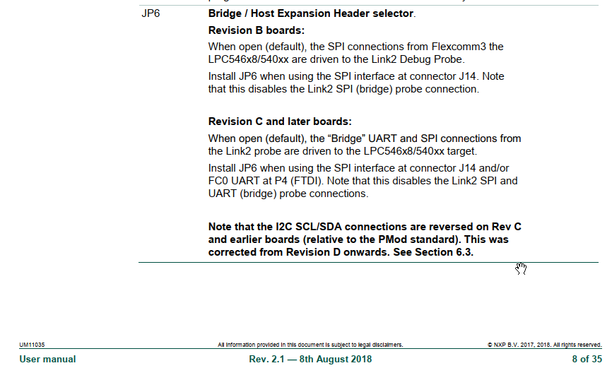

I restart again from the original demo uart polling which uses UART8. According to board user manual, you can find UART0 TX/RX pin on P4 but need you connect jumper JP6.
Teraterm output.

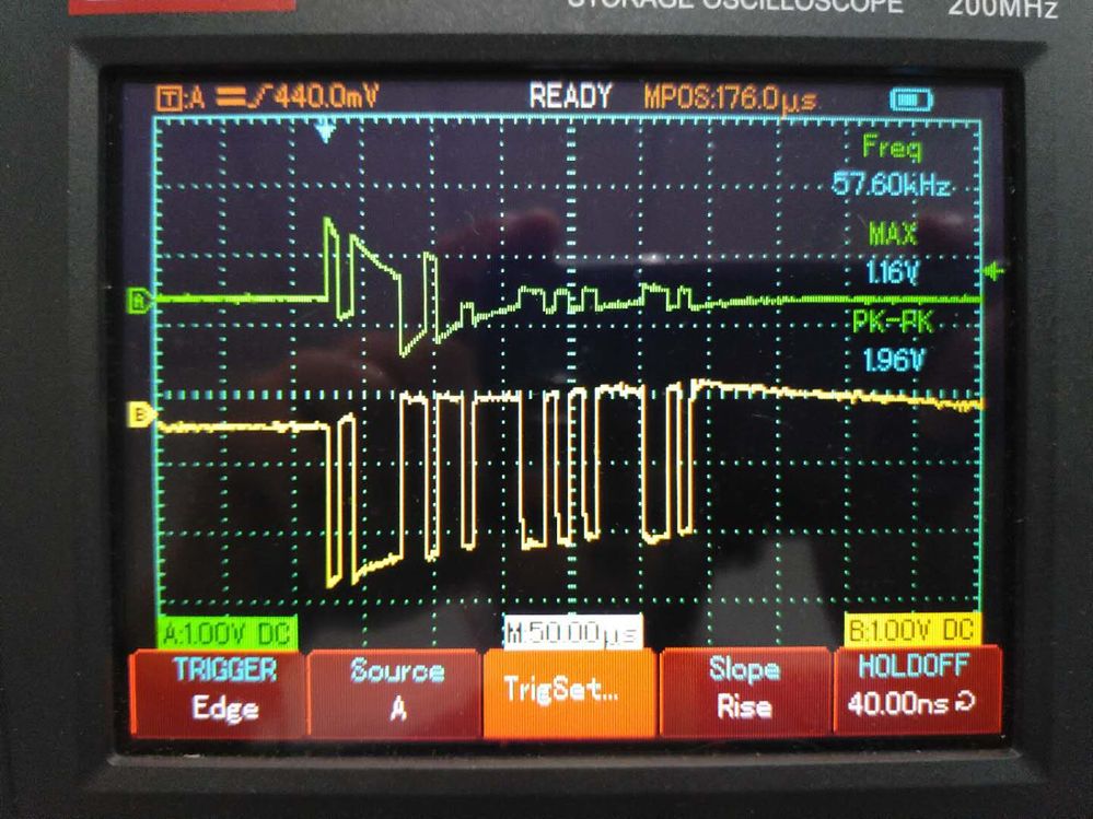

And signal for echo demo sending charactere "a" from Teraterm:
green is TTL_USB_TX connected to LPC RX.
yellow is TTL_USB_RX connected to LPC TX.
