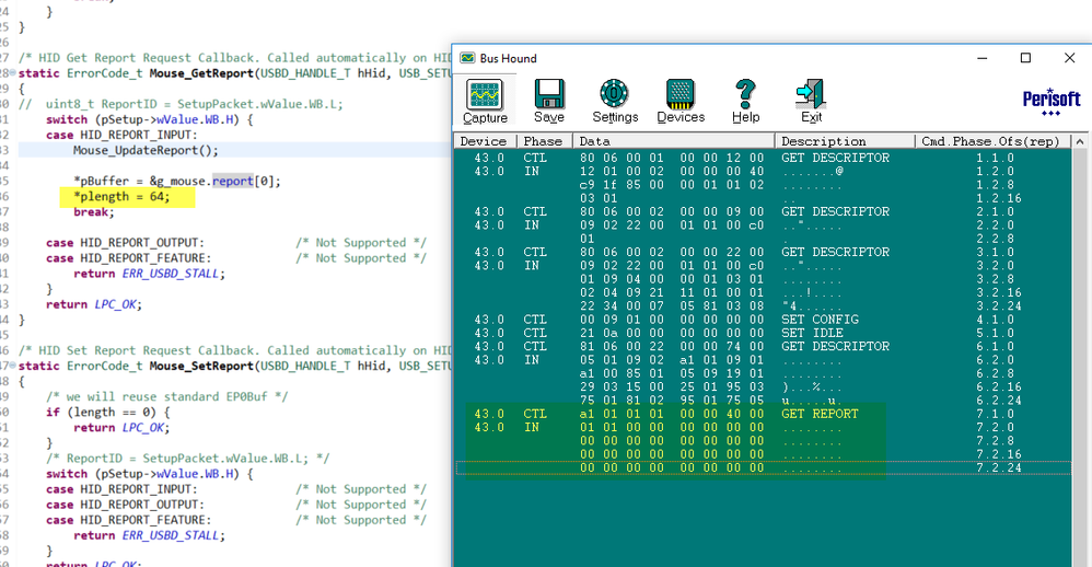

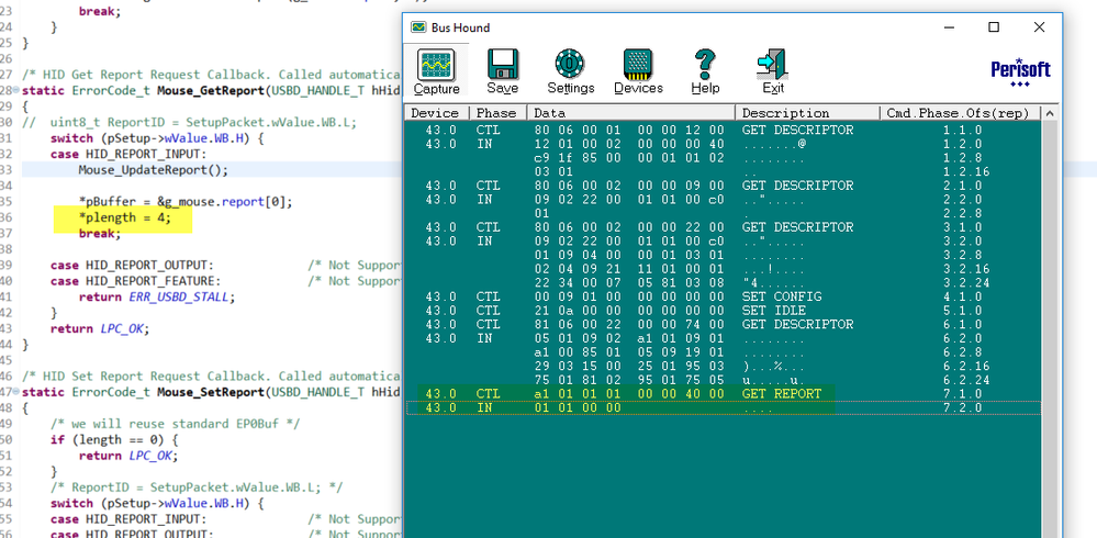

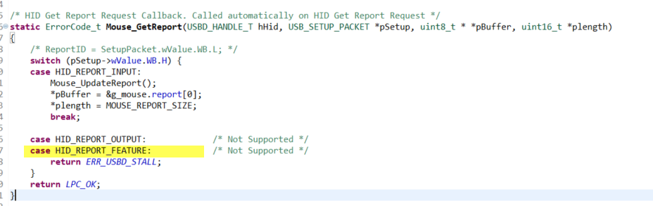

Hello  S S,
To my understanding, we need  refer to  the  "HID_ReportSize(x),  HID_ReportCount(x), " under each report ID, to define suitable "*plength" under GetReport() function also define the size of g_mouse.report[].
   case HID_REPORT_INPUT:
        Mouse_UpdateReport();
        *pBuffer = &g_mouse.report[0];
        *plength = 64;
        break;
And If you just want to change Report length, you can change the data of "*plength = ".
I haven't REPORT_FEATURE demo , also haven't a  good host tool like yours, so I just using
Bus Hound to test the report input,config *plength to 4 and 64, below is the result.
The Bus Hound sometimes doesn't show all the data, I think in your python code, you can see all the
64 bytes .

Hello S S,
How about the input_report in your code, does input_report[0] is right report ID ?
*pBuffer = input_report;
*plength = 64;
and the plength should equal input data +1 (Report ID).
About more then one ID, how do you configure Report description? Also check the report ID in Get report request in PC,
the input_report[0] should also use this report ID.  And what's the appearance about your said "doesn't work" ?
Also you can send me a simple project that can reproduce the problem, I will test it on my side .

Hello S S,
After finished the Report description, also Report data, then add the content in GetReport function as below:
set a breakpoint, check whether can run into it.
TIC
