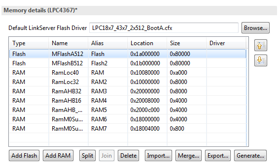

For M4 Core:

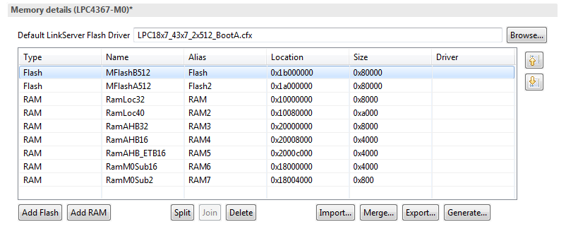

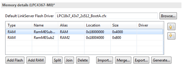

For M0App,
For M0Sub:

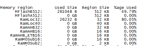

While developing the application i fund that the memory consumption (RAM) for M0App is almost 80% of 32KB for M0App core. It requires more RAM for further development.

Belwo mentioned is the screen shot of the compiled output of the code.

Regarding the RAM consumption of your project I see you have used around 27KB of the 154 KB of total SRAM you have available. I recommend you to check the following document that explains how you can relocate code and data to other RAM spaces using MCUXpresso.

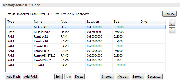

I have interfaced the SDRAM with the M4 Core, i can access it using the pointers., Now in that code I have created memory configuration as follows,
You can see i have added RAM7  0x28000000, 0X800000. Then after in the code the created the buffer in this RAM  Location
__SECTION(data,RAM7) uint16_t data_buffer[1024];
and then after refering the link you mentioned in tried that as well
__DATA(RAM7) uint16_t data_buffer[1024];

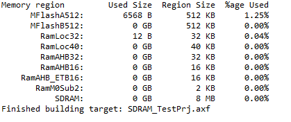

But still after compilation am not able to see the effect . Beloow is the compilation output
You can see there is no such allocation of the memory in the defined SDRAM location. It should show 2KB in used size column.
Also find the attached code for your reference,
