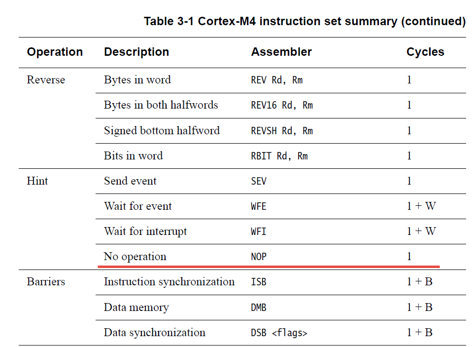

I recently tried to find out the number of instruction cycles used in boot loader & same in the user application using DWT registers provided in Cortex M4 and found out that "nop" instruction uses 42 instruction cycles in boot loader code(internal flash) whereas it takes around 3500 instruction cycles in user application.
Also learned that if I decrease clock frequency the instruction cycles actually decreases. I calculated that 1 instruction cycle = 1 machine cycle = 1 clock cycle & the minimum time I get is same as instruction cycles/CPU clock frequency.

I'm curious the testing flow you did, as according to the Cortex™-M4 Technical Reference Manual, nop instruction only cost 1 cycle. So I was wondering if you can share the more details about the testing procedure.
