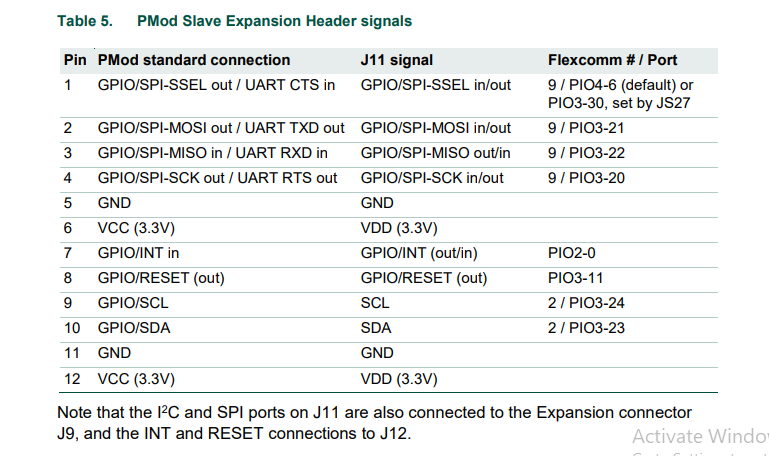

Hi s s,
    Do you also change the EXAMPLE_SPI_SSEL to 1?
   Please note:
P4_6 is the SSEL1, so you need to modify code:
#define EXAMPLE_SPI_SSEL 0
to
#define EXAMPLE_SPI_SSEL 1
Then try it again.
Besides, I think you also can check the SPI bus wave, whether the SPI bus data have the problems.
If you don't modify the SSEL to PIO4_6, just use the original code P3_30, do you also have the problems?
The original code without modification we have tested, it has no problem.

Hi Kerry,
I have changed JS27 and install JP6.
Image of the connection below:IMG_20181009_130005.jpg
using example lpcxpresso54618_driver_examples_spi_spi_interrupt from  SDK version 2.4.1 but data from destination buffer is : The 63 data is wrong, the data received is 255.

shaheenshamshad
Hi Kerry,
Yes, I have changed SSEL to 1.
Ok, I am trying with P3_30 for which I have to change JS27 and will update you here soon.
