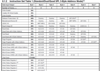

Hi, Gaurav,
I have checked the data sheet of W25Q256JV, I do not think that there is page erase command as the following figure. There is sector erase/Sector Erase (4KB) with 4-Byte Address/Block Erase (32KB)/Block Erase (64KB)/chip erase, but there is not page erase.
That is why there is not page erase api function in the software package I think, if I am wrong, pls update the thread.

Yes you are right. there no page erase option for the chip I am using. My query was regarding the sector erase only. If you see the code I shared there is Erase function which requires Addr and sector number as a parameter. This function is actually doing block erase not the sector erase. Sector erase is 4KB and Block erase is 64KB.
Inside the function named
uint32_t EraseSectors(uint32_t adr, uint32_t numsecs)
is actually performing block erase instead of sector erase. Following are the functions called inside the EraseSectors function,
spifiEraseByAddr and inside spifiEraseByAddr function spifiErase is called and inside spifiErase function pHandle->pFamFx->eraseBlock(pHandle, firstBlock); is called. Which I have verified ad my end.
So please confirm the same and also whether we can get the sector erase part inside the library or not?

I see your question, I am sure that the uint32_t EraseSectors(uint32_t adr, uint32_t numsecs) call the blockerase command.
If you want to implement the sector erase function, I suppose you have to implement it yourself. Because the LPC43xx is a bit old, in the latest spifi flash operation for LPC54xxx, we do not use the QSPI Flash Drivers architecture, so it is impossible to update QSPI Flash Drivers in future I think.
