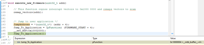

void execute_new_firmware(uint32_t addr)
	// This function copies interrupt vectors to 0x1000 0000 and remaps vectors to sram
	remap_vectors(addr);
	/* Jump to user application */
	JumpAddress = *(uint32_t*) (addr + 4);
	Jump_To_Application = (pFunction) (FIRMWARE_START + 4);
	__set_MSP(0x10002000);
	Jump_To_Application();

The check_info.new_address is blank, so we skip to 'exectute_new_firmware(0x2000)' which is where I'm failing.

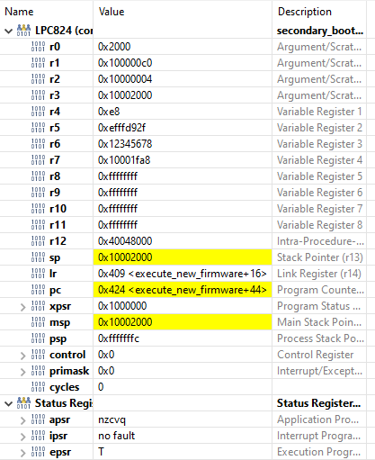

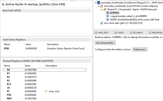

The code debug steps fine, up to calling "JumpToApplication()" whereupon I get a hard fault. My Registers before the final call:
The final call itself wants to move the PC to 0x1000 0004 - (FIRMWARE_START + 4)

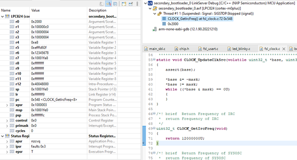

Immediately after that final JumpToApplication() call I have this in Registers:
The PC @ 0x548, and NOT 0x1000 0004. Is that significant?
Then when let to run freely, the debugger gives me a hard fault, and I'm not good at decoding these. Stack issue?? Please help.

To make the reset vector offset happen in the binary all I had to do was:
a) change the flash region from 0x0 -> 0x2000, and reduce size to 0x6000.
b) clean and compile.

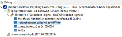

It is now 0x20e9 in the blinky binary. Upon download and execution, I get a successful jump to a new addresses in this order
--> 0x1000004 (reset vector in sram, which contains 0x000020e9, i.e. in the correct region of flash + thumb mode (right?))

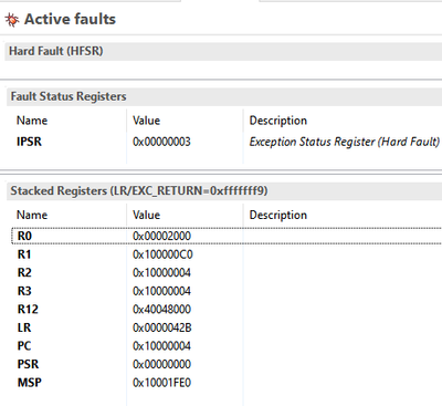

--> hardfault hander @ 0x2548 with this trace:

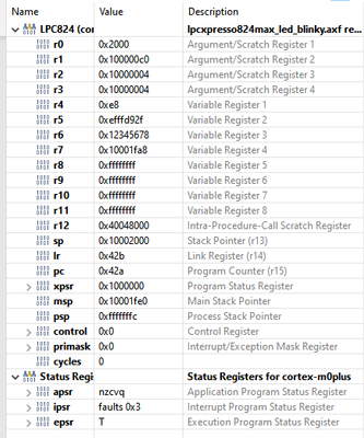

And active faults:
Registers:
So does this suggest bootloader working, but the application is bad and causing a hard fault?

I now think that the issue is the reset vector in the binary I've uploaded.
In the app example from AN11782 each of the two provided binaries for app have reset vectors: 0x50ED and 0x20ED which tracks to their intended flash address in the example.
My blinky app reset vect is 0xE9 and that's actually where the PC is jumping. So my linker script is the issue? That's not covered in the app note.
Also, the SP for both those example binaries is 0x2000, which tracks with call to set MSP @0x10002000. For my blinky it's 0x1FE0, so I imagine this is a linker script thing as well.
Does this all track?
