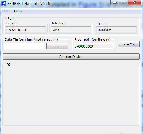

Hardware I have -
  • PE Multilink Universal and custom LPC54618J512BD208 board
I want to download hex file to board using above hardware using some standalone tools.
I cannot use FlashMagic due to hardware restrictions.
Of course I can do with MCUXpresso or Keil but those are complete IDE which is not an option for me.
Any standalone tools if available on internet please suggest!?
I'm open to buy new hardware if such tools exist.
Regards, Gmk

jeremyzhou
Thanks for your reply.
I'd like you to use the J-Flash Lite tool in the SEGGER as the below shows.
TIC
