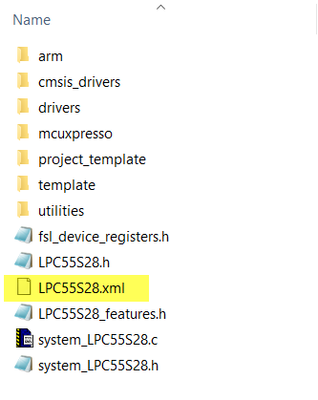

I am debugging a product with an LPC5528 mcu.  McuExpresso seems to know about the peripheral registers.  I need to debug in Ozone and have a Cmake based project.  Can someone help me locate the .svd file for this part?  I have hunted through the SDK files and also the mcuxpresso install area where I did create a hello world project for my target which worked fine.  I am on MacOs.  Thanks.

The SVD file is present in SDK, while it is not using *.svd extension. it is *.xml,
SDK_2.9.1_LPCXpresso55S28\devices\LPC55S28

Can this file be renamed to .svd extension to use it as such or does it need a conversion?

just rename it, no conversion needed.

Thank you.  Thats exactly what I needed
