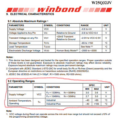

We're looking at using the LPC54018J4M in a project, interfacing with 1.8V peripherals.
On the product page (https://www.nxp.com/part/LPC54018J4MET180#/) it says the supply voltage is 1.71V to 3.6V
When I look at UM11155, page 6, it says Single power supply 2.7 V to 3.6 V.
Can we power the LPC54018J4M from a 1.8V supply?
7,419 Views
xiangjun_rong
You are right, the LPC54018J4M embedded Winbond W25Q32JV, pls download the data sheet of W25Q32JV from the website:
https://www.winbond.com/resource-files/w25q32jv%20revg%2003272018%20plus.pdf
This is the VDD requirement for the W25Q32JV.
The minimum VDD voltage is 2.7V
Hope it can help you

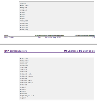

1.If we were to use the LPC54S016JET100 with a 1.8V Flash, can we program the flash through the SWD connection on the MCU, or do we need to use the bootloader?
>>>>>>Yes, you can program external spifi flash with SWD based on MCUXPresso tools, if it does not support the flash, you have to modify the *.cfx file.
This is the table the default spifi flash part number the current *.cfx supports.
For detailed inf, pls refer to the MCUXPresso_IDE_User_Guide.pdf located at:
C:\nxp\MCUXpressoIDE_11.8.0_1165
Secondly, you can download the flashloader to the RAM, using blhost tools to download via uart or usb in ISP mode.

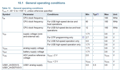

7,440 Views
xiangjun_rong
As the following section 10.1 General Operating conditions in data sheet of LPC540xx, the VDD can be 1.8V, but if you want to program OTP, the VDD power supply voltage must be 2.7V or above. if you use full speed USB, the VDD power supply voltage must be 3.0V or above.
XiangJun Rong

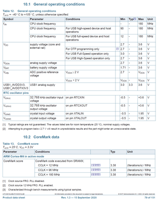

7,427 Views
andrewsglenn
Hi again.
The Revision 1.3 datasheet from 15 September 2020 shows a minimum Vdd of 2.7V, which is what is confusing me. This is the datasheet available for download from the NXP web site.
Is this because the LPC54018J4M contains an internal SPI flash that needs a higher voltage?
