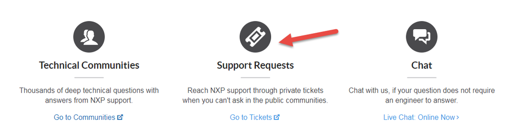

jeremyzhou
Hi Hanno Braun,
Please create a request about this report , I will escalate its priority to be solved.

hannobraun
Thank you, jeremyzhou‌!
I've created support request 00201109. Unfortunately it looks like to me like all my formatting was removed, making the description quite horrible to read. I hope it looks better on your end.
