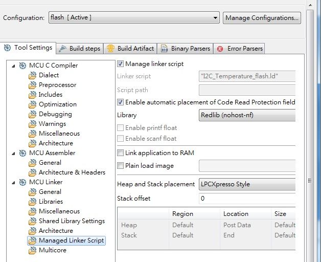

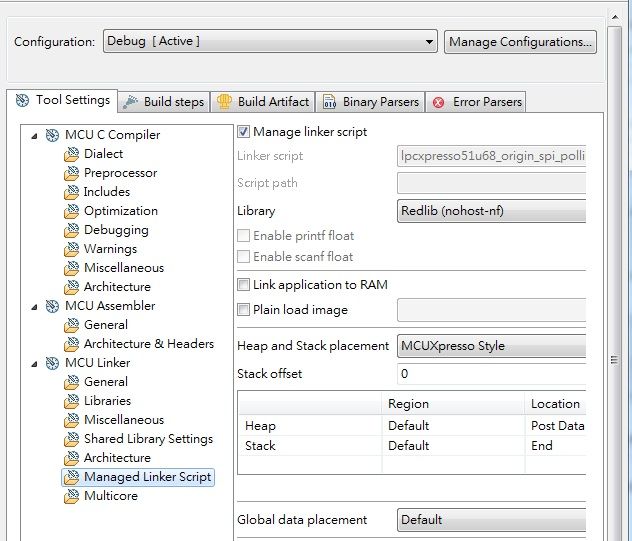

I try to do CRP in LPC51U68 in MCUxpresso.
I can see CRP enable option in LPC804. But I can’t see it in LPC51U68.
Why difference?
How to set CRP protection in LPC51U68 based on MCUxPresso?
 LPC804 Project
LPC51U68 Project
3,069 Views
lpcxpresso_supp
There is currently some missing config info in the SDK that the IDE requires for enabling this option. This should be resolved in a future SDK release, But for now, you can easily "fix" this issue locally. This can be done as follows...
