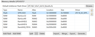

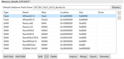

Hi ,

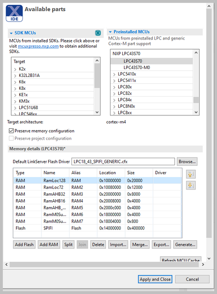

I am using LPC4367 controller based evaluation board OM13088. I an trying to create the project which will use external flash for downloading the code instead of on chip flash.
I have created the project which is attached. Please check and let me know whether it is the proper one or need some modification in the project created.
while debugging the code, I am getting below error,
MCUXpresso IDE RedlinkMulti Driver v11.2 (Sep 22 2020 13:23:35 - crt_emu_cm_redlink build 19)
Found chip XML file in C:/Gaurav More/Project/New Feeder Relay/F4/SourceCode/CPU/TestCode/SPIFI_BOOT_2/Test_SPIFI_Prj/Debug\LPC4337.xml
Reconnected to existing LinkServer process.
Probe Firmware: LPC-LINK2 CMSIS-DAP V5.361 (NXP Semiconductors)
Serial Number: BSARBQEQ
VID:PID: 1FC9:0090
USB Path: \\?\hid#vid_1fc9&pid_0090&mi_00#8&11bf0f26&0&0000#{4d1e55b2-f16f-11cf-88cb-001111000030}
Using memory from core 0 after searching for a good core
debug interface type = Cortex-M3/4 (DAP DP ID 2BA01477) over SWD TAP 0
processor type = Cortex-M4 (CPU ID 00000C24) on DAP AP 0
number of h/w breakpoints = 6
number of flash patches = 2
number of h/w watchpoints = 4
Probe(0): Connected&Reset. DpID: 2BA01477. CpuID: 00000C24. Info: <None>
Debug protocol: SWD. RTCK: Disabled. Vector catch: Disabled.
Content of CoreSight Debug ROM(s):
RBASE E00FF000: CID B105100D PID 04000BB4C4 ROM (type 0x1)
ROM 1 E000E000: CID B105E00D PID 04000BB00C Gen SCS (type 0x0)
ROM 1 E0001000: CID B105E00D PID 04003BB002 Gen DWT (type 0x0)
ROM 1 E0002000: CID B105E00D PID 04002BB003 Gen FPB (type 0x0)
ROM 1 E0000000: CID B105E00D PID 04003BB001 Gen ITM (type 0x0)
ROM 1 E0040000: CID B105900D PID 04000BB9A1 CSt TPIU type 0x11 Trace Sink - TPIU
ROM 1 E0041000: CID B105900D PID 04000BB925 CSt ETM type 0x13 Trace Source - Core
NXP: LPC4337
DAP stride is 4096 bytes (1024 words)
Inspected v.2 External Flash Device on SPI LPC18_43_SPIFI_GENERIC.cfx
Image 'LPC18/43 Generic SPIFI Sep 25 2020 10:51:00'
Opening flash driver LPC18_43_SPIFI_GENERIC.cfx
Sending VECTRESET to run flash driver
Driver V.2 dynamic startup failed - driver Init provided no flash parameters
Flash Driver V.2 startup failed - rc Ef(55): Dynamic flash driver startup failed to provide flash parameters.
Terminate (0x0, 0x0, 0x0) status 0x40 - driver reports init failure - EXTSPI driver rc 13 - No supported SPIFI device found
chip initialization failed - Ef(55): Dynamic flash driver startup failed to provide flash parameters.
failed to initialize flash driver LPC18_43_SPIFI_GENERIC.cfx
Not able to get the reason for the same. since the SPIFI flash used  in the Evaluation board is MX25L8035EM2I-10G.

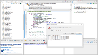

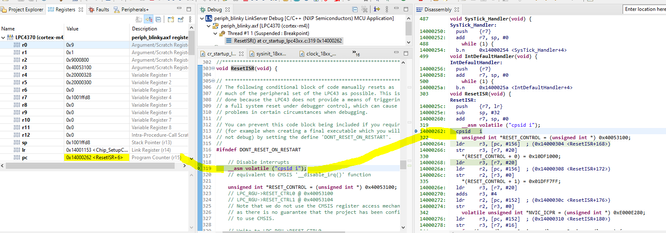

Ok, After being able to flash the application . Then debugging   and receiving those errors, as you are not able to execute main(), you have changed to Reset ISR , so this is the trace:
Test_SPIFI_Prj,->ResetISR()-> system_init() -> Board_SystemInit->Board_SetupClocking                          ->Chip_SetupCoreClock->Chip_Clock_CalcMainPLLValue() ,
So,  in some place of the last function you get stuck at when writing or reading at any part of the CGU clocks related to the PLL  , correct?
This seems very familiar to what  other customers have faced at this thread:
https://community.nxp.com/t5/MCUXpresso-IDE/LPC4330-LPC-Link2-new-IDE-Bug-or-potential-Errata-issue/...
Other thing that may help is to check if all of this functions running  from above the memory address for SPIFI  of 0x1400_0000 ?
For example I use to check this  using disassembly view and the processor PC.

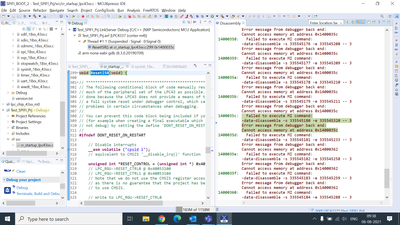

gauravmore
Hi Diego,
Thanks for the response,

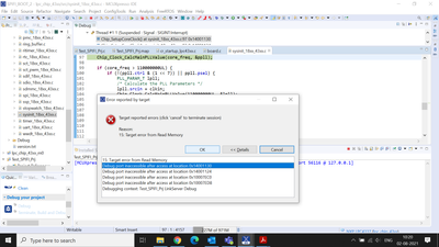

As per your input I also checked the same at my end.  I have taken a screen shot of the same. Refer the below screen shot.
It is similar to what you have posted. But when I run the code, one more observation is there , this may help you since I am not able to make out. Refer the screen shot below,
Here you can see it show fail to execute for MI command, It seem that some how debugger is not able to read or access the QSPI flash.

diego_charles
Hi @gauravmore
I was able to jump to main application , by commenting out ( in a quick and dirty fashion)  the Chip_Clock_DisableMainPLL() , which  leads to the errors we have experimented , inside  Chip_SetupCoreClock function.
it seems that the board init routines  , do something that does not fit when we boot from a external flash. Yet , we will have to debug further this.
Therefore it seems that your project settings are ok,  but we do not have the same LPC chips and the same boards ( I am actually using an LPC-Link 2 as a target ), Could you try from your side?
All the best
Diego.

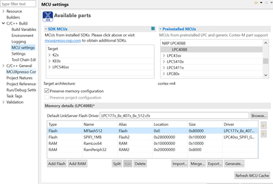

One more query:  I was referring the code given in the below link,
 https://www.lpcware.com/content/faq/lpcxpresso/configuring-projects-multiple-flash
You have share the code for LPC4088. But in that code along with the M4 core SPIFI memory is also used,
So s per the input  we can use it as a external memory but in this project I am not able to find the Allocation of the constant variable. But in the console it show that memory allocated,
need your help regarding the same. Since we also tryin this option in our application. Not able to find as in how this memory or the variable is allocated in the QSPIFI memory.

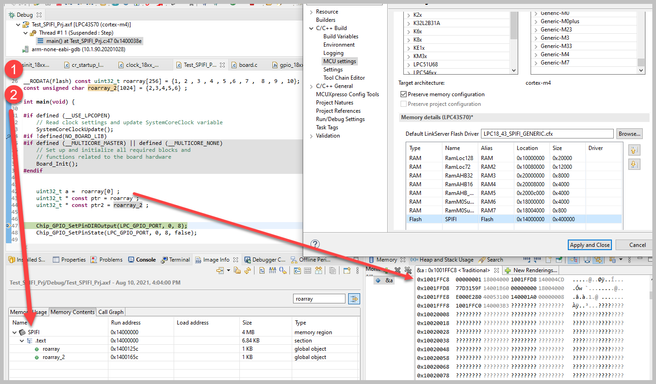

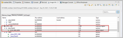

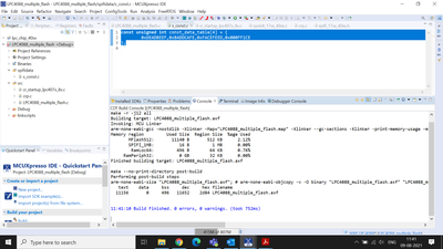

If we also want to statically  allocate variables in the external flash memory, like the like  const_data_table array from the example for the LPC4088
I have some comments:
 1 When we have multi-flash project, like the one for the LPC4088  we can follow this tutorial  Configuring projects to span multiple flash devices : you may use  simplest way using the cr_section_macros.h   directives or create your own linker script configuration.
 2 From the image above , it can be seen that the const_data_table is allocated at the base address of the external flash .  In contrast to  applications that boot from a external flash , where  the base address is used  for the vector table.
Here is a snapshot of me allocating two constant arrays in my project , that boots from the external flash.  You can see how I am  allocating the 2 arrays :  the first one using  the  cr_section_macros.h RODATA directive ;  and the second just declaring a constant array, since I only have one flash area the linker automatically allocates that array in the external flash.
The Image info window ,is also  useful to know where our variables and functions are allocated.
I hope this could help you.

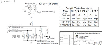

In your case, one simple hypothesis could be that the boot options pins do not have a fixed state for SPIFI ; and the MCU is booting in other option.
I think It could be the reason, I will check regarding the same. But still since you are using OEM13088 board can you share the Pin configuration done on the board? I Also did the same but still there might be some glitch,
Also regarding the allocation of the variable to the flash, in the given example of LPC4088 constant data is allocated in the Flash memory using __RODATA() attribute, in a similar manner can we assign the normal variable in the same area using the above attribute?
Main agenda behind this is Want to use generic flash driver and using that i want to use this SPIFI flash to store some critical variable with data in it instead of separately calling the read write function, similar to the SDRAM interface where we just need to initialize the EMI lines and then rest is taken care by the controller engine . Whenever we access the variable then it automatically use the EMI engine to access the address where the variable is stored.
Also Still as per the image below, it seems that you are viewing the axf file data, What I want is the place where this constant variable is assigned to the SPIFI address. Similar to the one you shared, __RODATA() attribute.

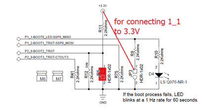

Yes till I am facing issue with respect to the booting of SPIFI. Also find the connection done at my side on OEM13088 eval board,
refer the attached schematic of the evaluation board as well.

In the similar manner  I want to use QSPI flash, where I have configured the flash drivers in the memory configuration section,
Now referring to the example code of LPC4088 I can see that there is a read only variable allocated and is it accessed in the code. But now is is possible to allocate the R/W variables so that I can assign the critical structure mentioned above in the flash memory directly since it will allocate the available space in the flash which reduces the efforts of specific assignment .

1 Regarding SPIFI boot without a debugger.
   Today I tested ,with a colleague of mine,  the attached project on the LPC43s67 OM13084.  To boot with project and see the red LED blinking , we  pressed the ISP button during reset and set the JP3 and JP5 according to the following snapshot from the OM , user guide. Let me know if it works for you.
