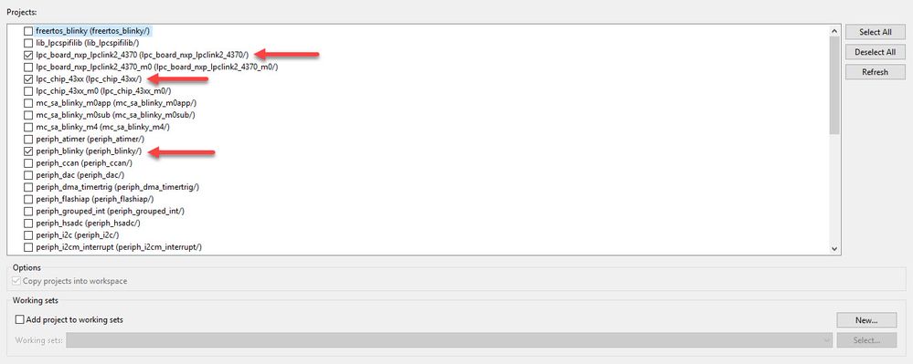

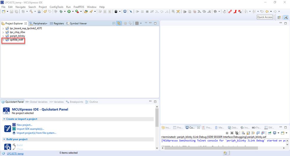

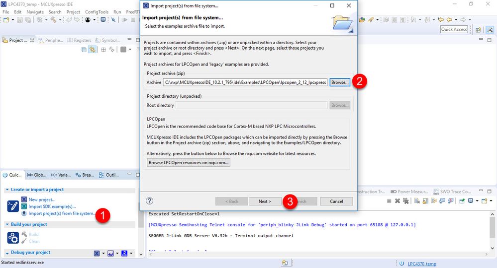

In your workspace of MCUXpresso we will import (1) three projects of the LPCOpen v2_12 for the LPC4370: periph_blinky, lpc_board_nxp_lpclink2_4370 and lpc_chip_43xx.  The LPCOpen zip file is in the next path of your PC: C:\nxp\MCUXpressoIDE_10.2.1_795\ide\Examples\LPCOpen (2)
Extract the files of the zip named lpclibspifi_lpcxpresso_1.03_68 that we downloaded before. The folder that we need is spifilib_m4f. Drag and drop this folder into the Project Explorer on your workspace of the LPC4370, after choosing copy and you should see the spifilib_m4f in your Project Explorer.

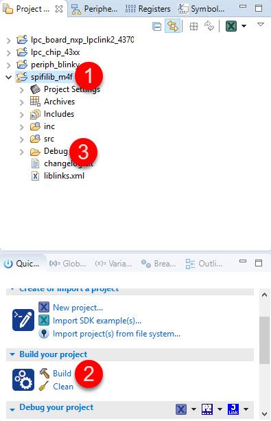

Once you imported correctly the SPIFI library, select the library (1) on the project explorer window and build it (2). Once you do this you should see that a new folder called Debug appear (3).

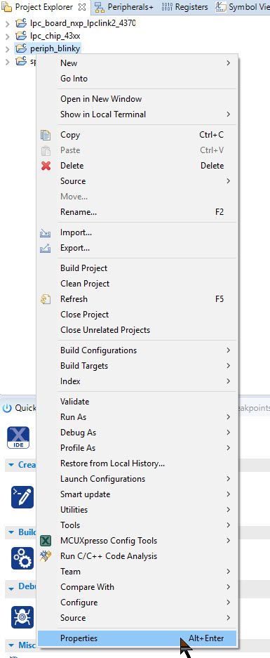

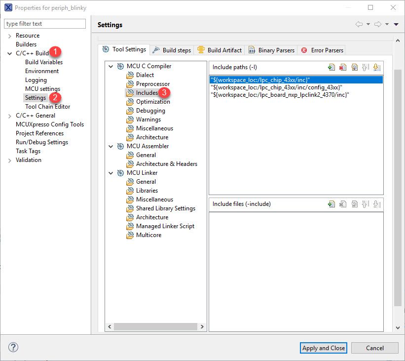

Now we need to edit the properties of the periph_blinky example to add the library spifilib_m4f to the project. To do this, right click on the project and click properties.
Once in the properties window click on C/C++ Build (1) > Settings (2) > Includes (under the section MCU C Compiler) (3).

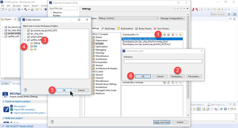

In the includes window click Add… (1) > Workspace (2) > spifilib_m4f (3) > inc (4) > click OK (5) on the window Folder Selection > click OK (6) on the window Add directory path.
You should see the following on the include paths.

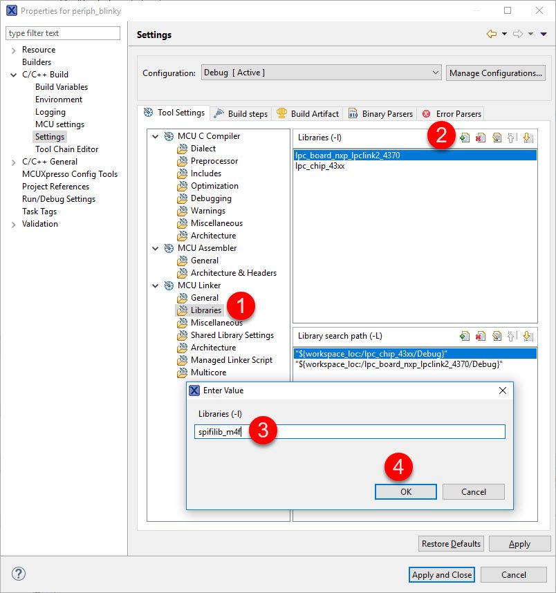

Now, go to the libraries (1) option under the section MCU Linker, on the section Libraries (-I) click Add… (2) finally write the name of the library (spifilib_m4f) (3) and click OK (4).

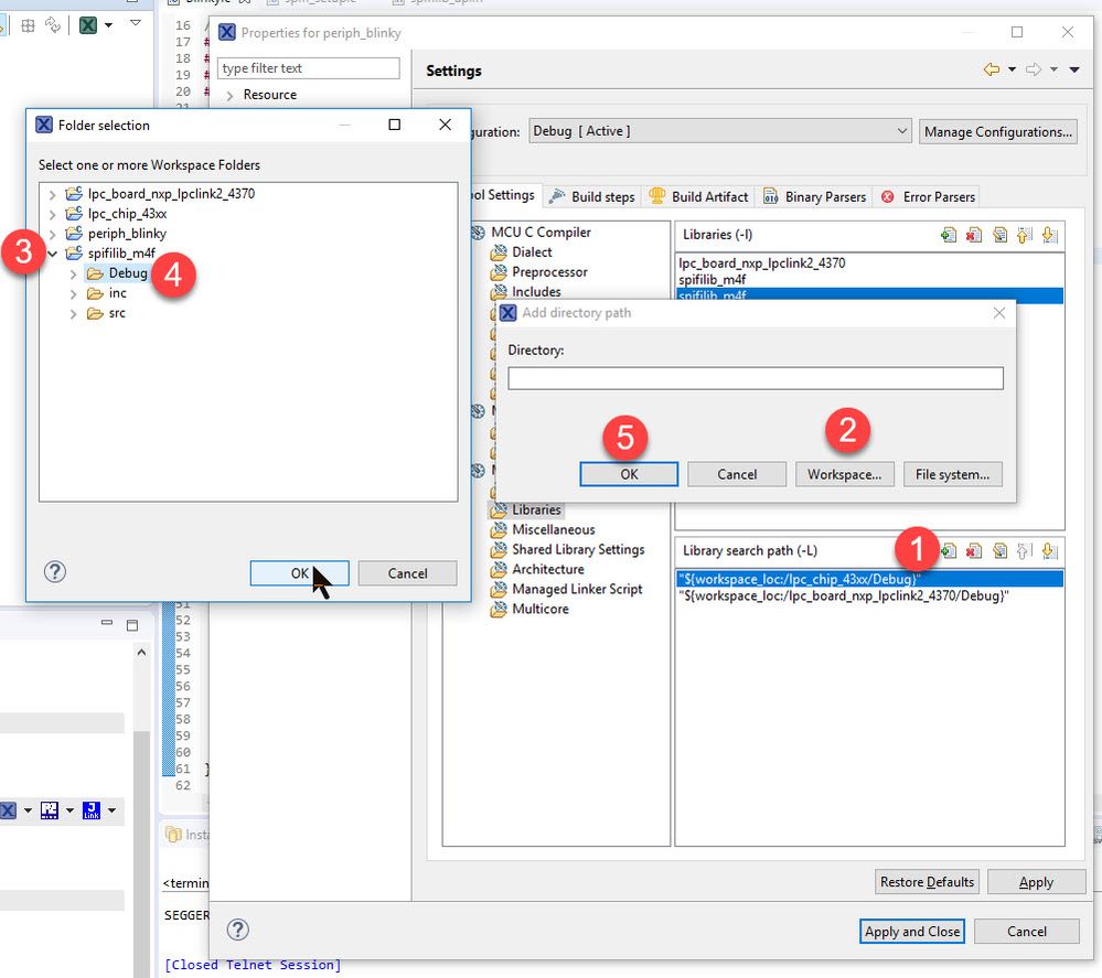

Under the section Library search path (-L) click Add… (1) > Workspace (2) > spifilib_m4f (3) > Debug (4) > OK (5).
If you see the same as shown in the below image you are good to go so click Apply and close.

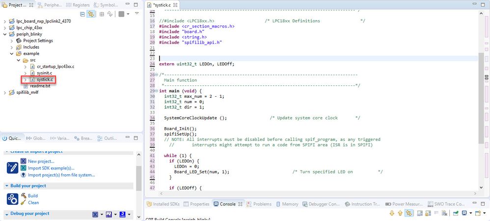

To check if you did the below steps correct let’s do the following. On the project periph_blinky in the file systick.c include the file spifilib_api.h and compile the project. If the project compiles without problems it means that you imported correctly the spifi library. If you found problems please stop and repeat all the steps mentioned before.

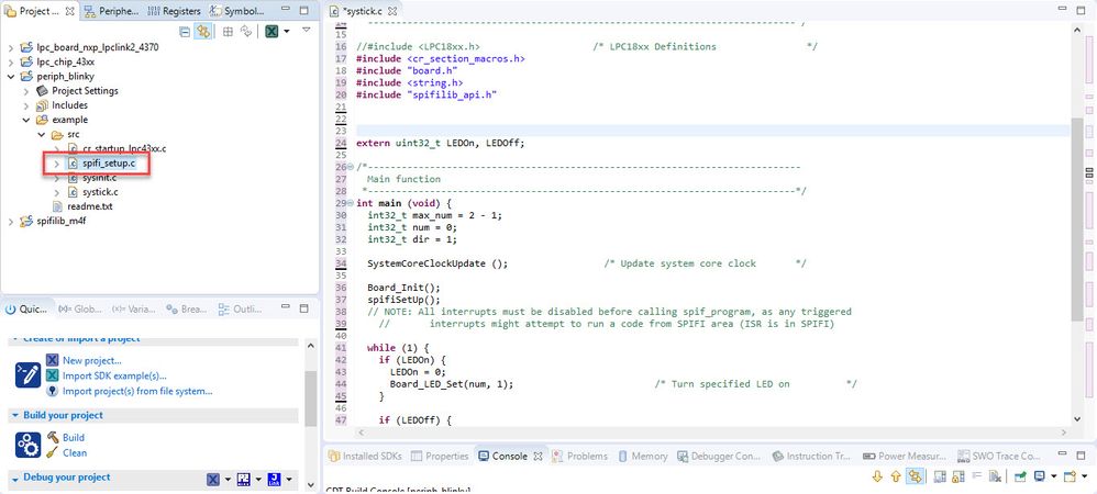

Go back to the path spifilib_blinky > example > src on your PC. Drag and drop the file called spifi_setup.c into the folder src of your project periph_blinky on your Workspace.

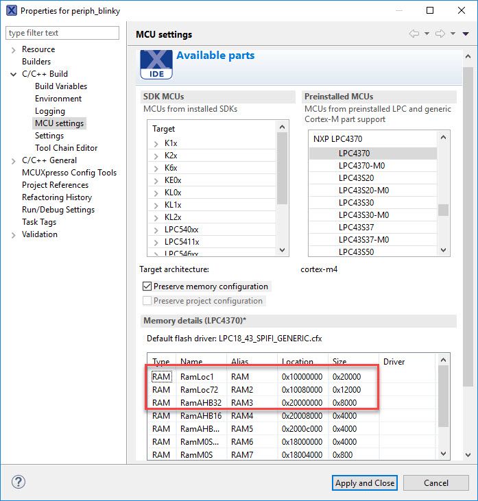

Open the file that we just copy into our workspace and go to line 46 of the code. Here we are creating a buffer of 64KB that we will use later to write in the SPIFI. The __BSS(RAM3) is to save this buffer in the RAM block three of memory. The problem here is that the block of RAM3 in the LPC4370 is not big enough to store the buffer of 64KB (see below image), so let’s change this for either RAM or RAM2 that are big enough to store the buffer.
Now that we added the spifi_setup file let’s go back to the systick.c file and add the external declaration for the function spifiSetUp. At this point, if we compile the project we shouldn’t see any problems, only some warnings because of the functions and variables that we are not using.

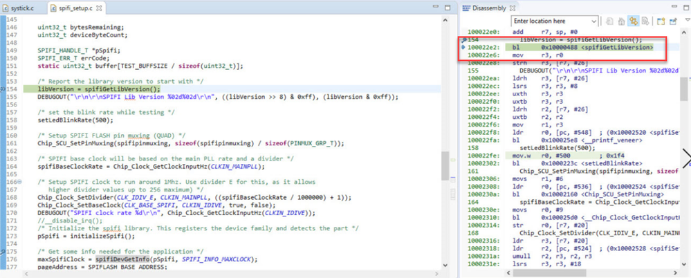

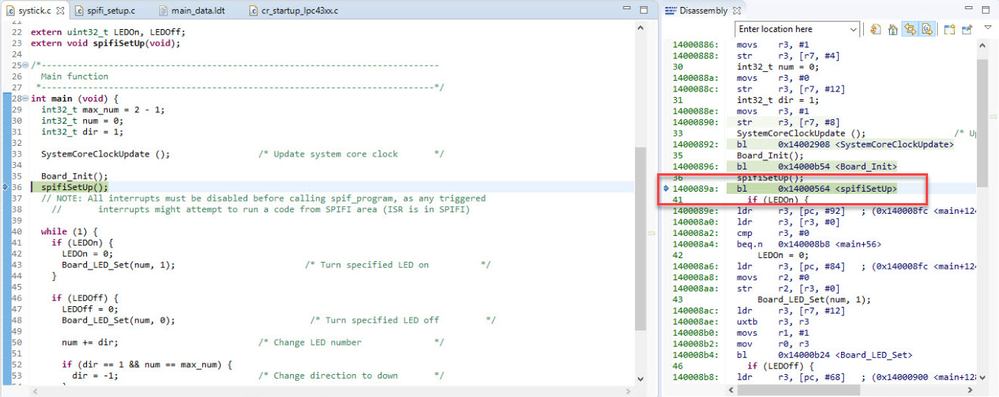

After finishing with the three files you are done with the demo! It’s important to mention that if you want to go inside the function spifiSetUp while debugging you need to set a breakpoint inside the function.
While debugging we can see that before calling the function spifiSetUp we are running from the SPIFI flash memory and once we enter to the function we are running from RAM memory.

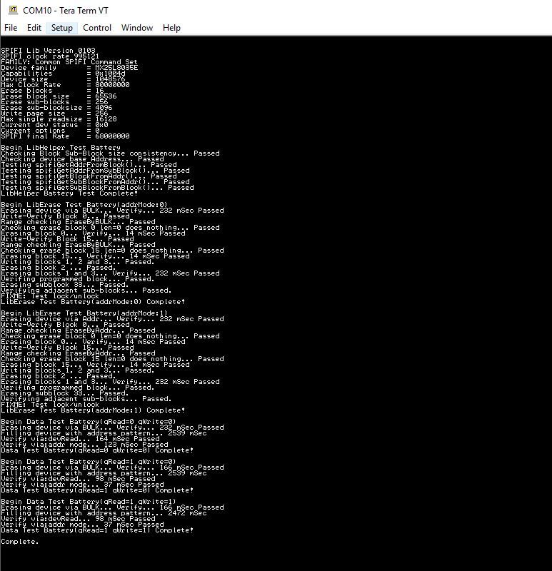

Once we run the demo successfully we should see the following in a terminal and the LED1 will be blinking.
