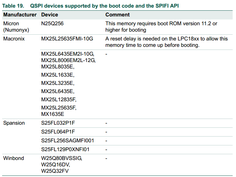

Hi Kai Becker,
According to reference manual, the S25FL129 will work with 32 MHz when choose the SPIFI boot mode (See Fig1 ).
                                                               Fig 1
It seems so weird, and you should relocate these API in the RAM prior to utilize the SPIFI library API.
And I'd like to share a thread :Relocating code from FLASH to RAM with you, and please refer to details.

kaibecker
Hi Ping,
thank you very much for your answer.
The S25FL129 should work with even higher frequencies. According to the datasheet of the S25FL129P0XMFI010 it should work with 80MHz.
As I said. I see on my oscilloscope that the boot process starts with 32MHz (quad)
and is then reduced to 18MHz after ~0,5s - 1s.
Yes you´re right concerning the relocation of the SPIFI API.
I have to read the IAR Linker manual to see how the relocation is done using the IAR Embedded Workbench.
You´re link refers to the LPCXpresso IDE which uses the gcc compiler/linker.
This syntax surely differs from the IAR syntax.
The relocation of the SPIFI Lib API could be a first try, but even if I manage to relocate the SPIFI Lib API to RAM, I don´t understand how to increase the SPIFI Clock Speed.
In the SPIFI Lib there is now call or parameter for the SPIFI Clock.
Maybe others here have an idea?
