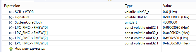

By googling I landed by chance here (LPC Signature Generator | mbed ), and I decided to give it a try, to test the code which is presented there even though is for antoher LPC family, suppoed to have a 128bit signature generator.
Well, I was quite surprise to see that the first word of the software posted on mbed was matching the signature which I calculated in HW on my LPCXPresso mounting a LPC11U68JBD100 device, which is supposed to have a 32bit signature genreator.
Seen that, driven by my curiosity I tried to access the register FMSW1, which should not exist. And, funny enough, the register does exists and it contains the correct signature. So do also FMSW2 and FMSW3.
How cool is that? The LPC11U68 does actually have a 128bit generator, and not 32bit as you (NXP) claim.
So, to me it seams that you (NXP) don't actually know what you put in your silicon...
As a customer, what should I do? Implement my application according of what I see, with the risk that you decide to change the HW and my application will not work anymore. Or stick to what the user manual says, with the result that my application wont work at all?
Or look for another chip provider?

PS: I attach a screen shot of the debugging tool, which shows the ghost registers.
