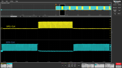

My goal is to have SPI0 and SPI1 running simultaneously using the periph_spi_sm_int sdk example project.  The reason for using this version of the SDK is because legacy code I am working with assumes the usage of these SPI drivers.
I’ve modified the periph_spi_sm_int project so both SPI0 and SPI1 are configured as masters. Again, I want to have both SPIs running simultaneously. What I mean by this is after I initiate the first SPI0 transfer I immediately initiate the SPI1 transfer. In the main loop, I use the Chip_SPIM_Xfer non-blocking function to initiate the SPI0 transfer. In the next line, I initiate the transfer for SPI1. This should in theory have both SPI transfers running simultaneously with SPI0 having a small head start. See spi_sm_int.c line 380.
From my understanding the Chip_SPIM_Xfer function is non-blocking. This would mean that two SPI peripherals should be able to transfer data simultaneously. I'm probing the SPI0 and SPI1 clock lines with an Oscope and I don't see these clocks active simultaneously.
As an experiment I did the same thing with the latest SDK spi_interrupt_b2b_transfer. I configured both SPI0 and SPI1 as masters and had them run back-to-back transfers . In this case, I did see both SPI peripherals active simultaneously.
Question:
Is there a way to get both SPIs to run simultaneously using the periph_spi_sm_int example project?

Hello @rhsalced
Thank you for your question.
I compared the code between the SDK and LPCopen. It seems that in the SDK driver, there is a piece of code to set the SPI state:
/* Set the SPI state to busy */
handle->state = kStatus_SPI_Busy;
You could try adding this to the LPCopen driver.
If it still doesn't work, try sending only 1 byte.
If all else fails, you can port the SDK SPI driver into your code.
Alice
