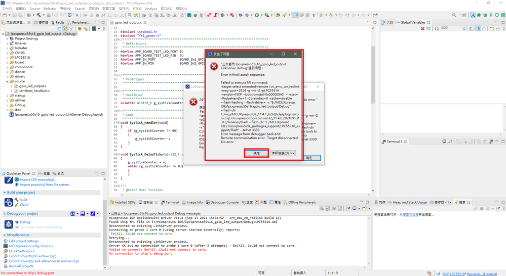

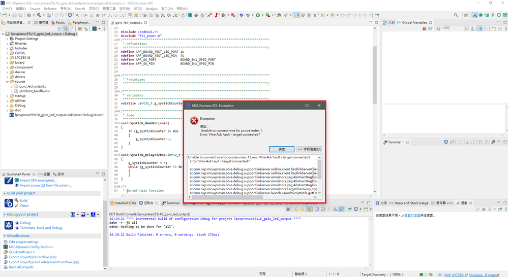

LPC55S16-EVK : Failed on connect: Ee(42). Could not connect to core. No connection to chip's debug p
2,816件の閲覧回数
emmt55s16

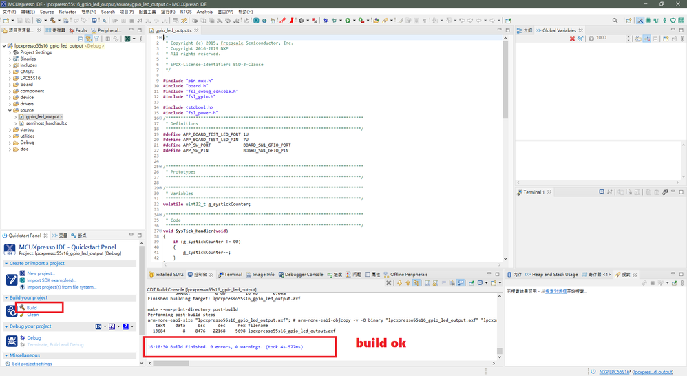

Hi,everyone:
It is solved,thanks!
I have another question,
Why is it causing such an error, can someone tell me?
thanks!

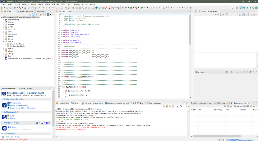

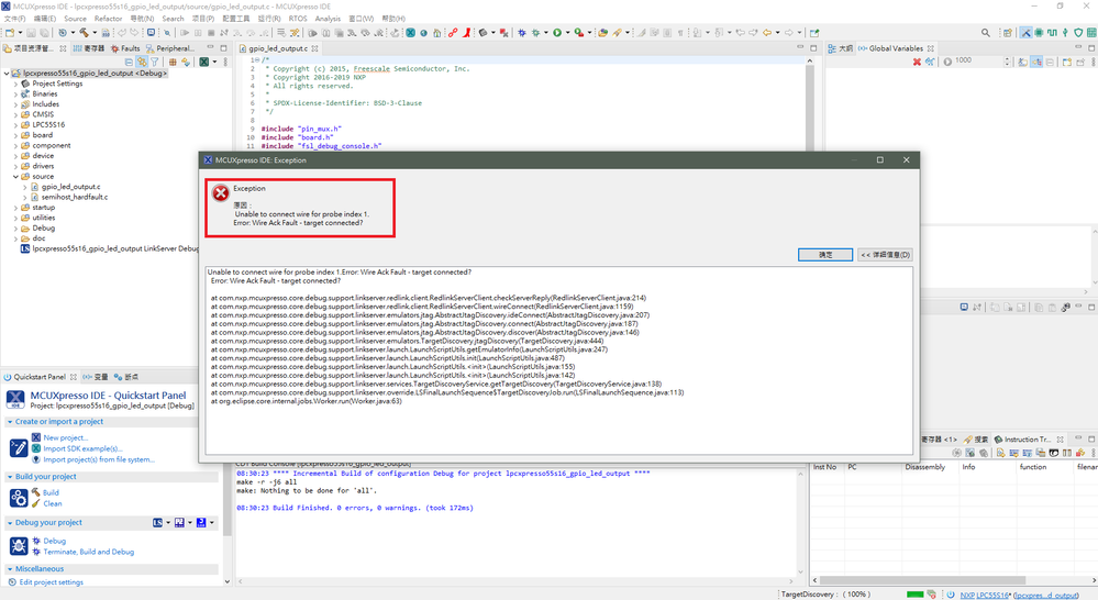

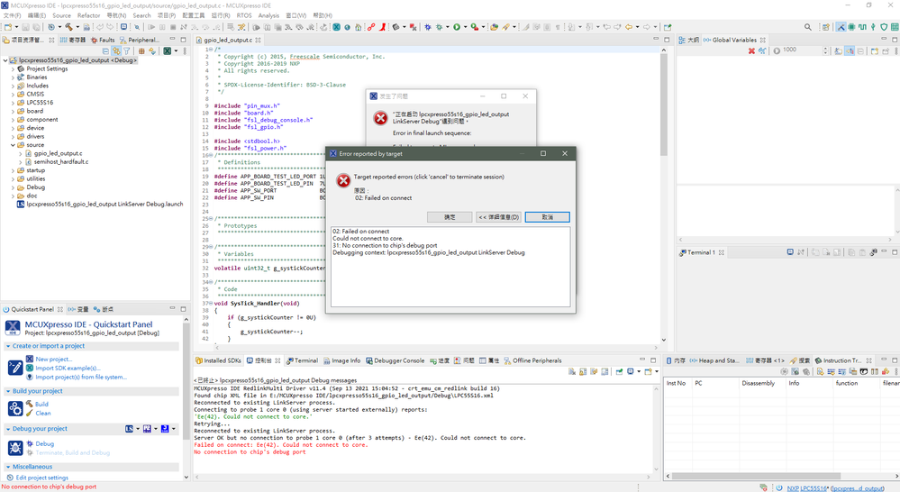

Hi, everyone :
How to solve the error generated under debug ????

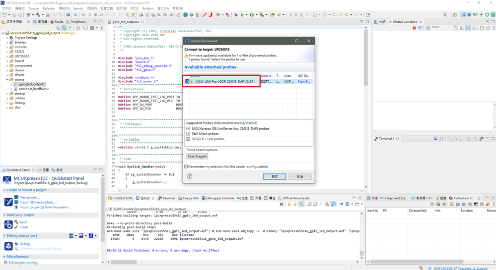

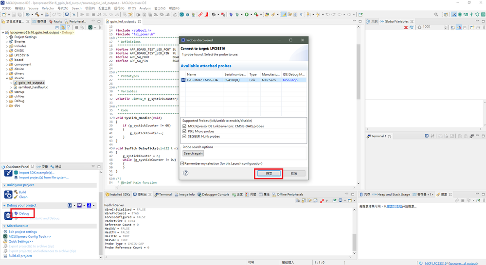

Both types of programming using MCU-LIN PRO or EVK-LINK2 produce the same error, thanks!!

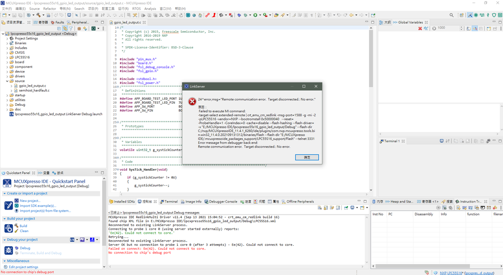

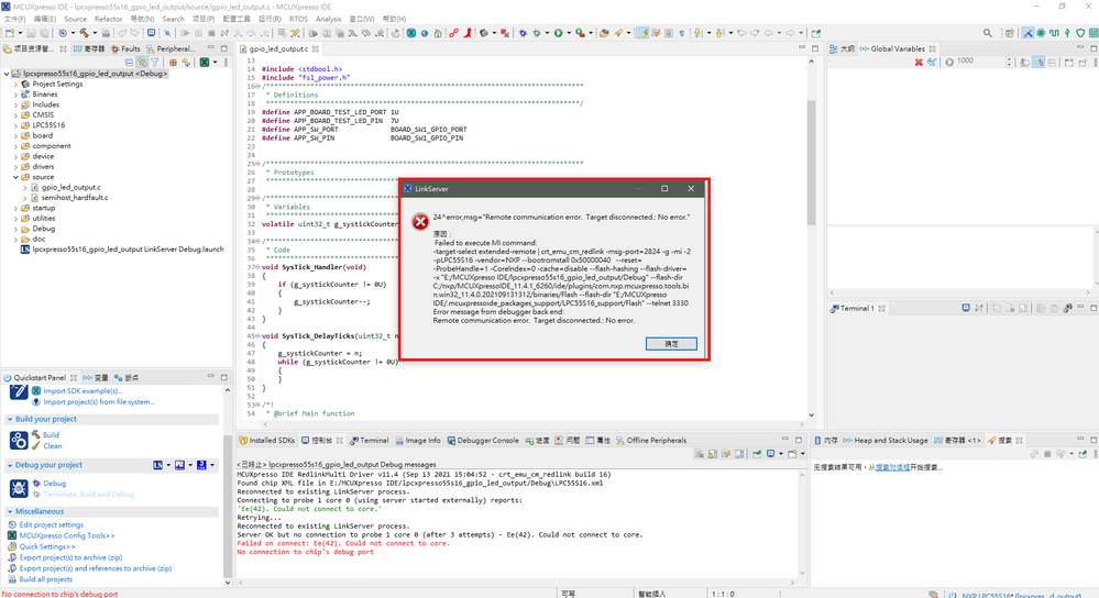

LINK2 Debug :

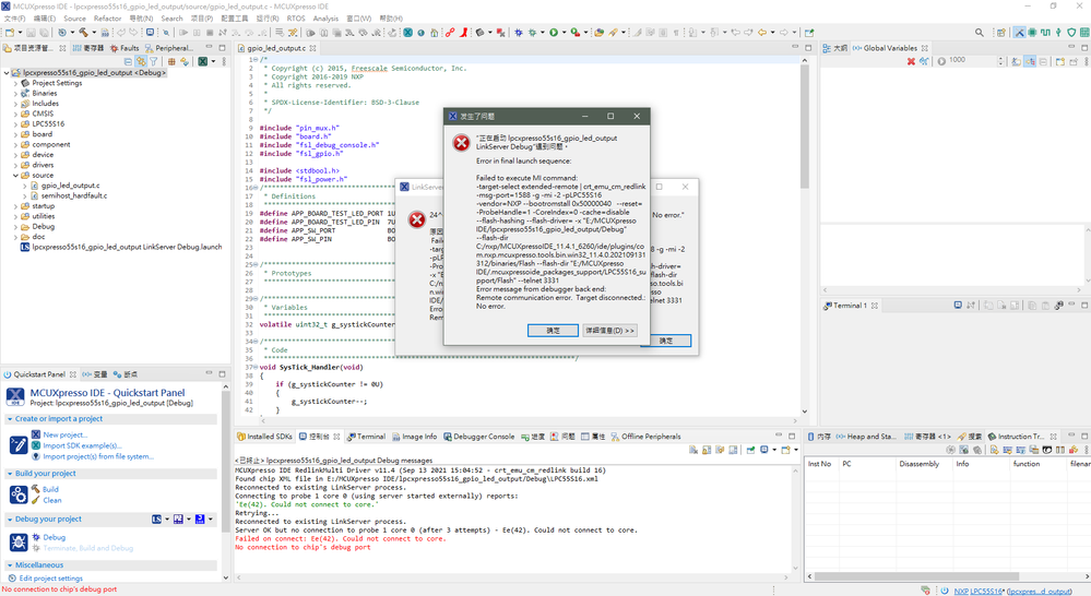

MCU-LINK PRO Debug :
MCU-LINK-0001.pngMCU-LINK-0002.pngMCU-LINK-0003.pngMCU-LINK-0004.pngMCU-LINK-0005.pngMCU-LINK-0006.png
How to solve the error, thanks !!!
I perform the same steps in another LPC55S16-EVK , it’s okay in another LPC55S16-EVK , No error occurred
2,791件の閲覧回数

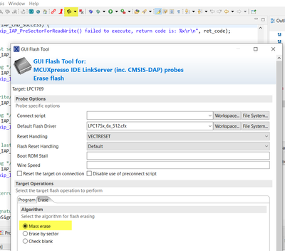

Hello emmt55s16,
Please erase the flash first, using GUI Flash tool
If still can't work,   enter ISP mode using Flash Magic to erase.
Or try to hold on ISP pin when reset board, and do not release until finish debug.
