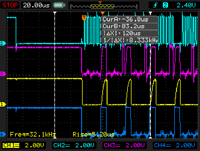

 1   If the TX FIFO is empty, what is transmitted on MISO -- 0x00, 0xFF, or a repeat of the previous byte?
= I have tested it, it should be 0X00 if none data input to the transmit buffer, this is my test result
The yellow wave is the MISO, you can find it is the 0x00.
