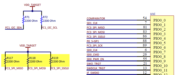

Hi support team,
  There are three 2.2Kohm pull-up resistors connected on the LPC55S69 SPI interface in our LPC55S69 EVB.
Would like to ask why it needs these pull-up R for a SPI bus which has no pull-up R in general.
Are these R necessary ? Are our SPI pins(SPI_MISO, SPI_MOSI, SPI_SSEL) open-drain and must pull high externally ?  or transmission speed concern.
Thanks.

Hi, StanleyH,
As you know that the FlexComm3 module(FC3 module) can be configured as Uart, SPI, I2C and I2S, if the FC3 is configured as I2C, it's signal pads SDA/SCL pins are Open Drain, the external pull-up resistor are required. Of course, if the FC3 is configured as SPI, the SPI signals are push-pull driven, the external pull-up resistors are unnecessary, but the 2.2K ohm pull-up resistor does take effect on the SPI data transfer.
This is the FC3 signal assignment for LPC55S69:
PIO0_2,     FC3_TXD_SCL_MISO_WS, the pin is SCL signal of I2C if FC3 is configured as I2C.
PIO0_3,      FC3_RXD_SDA_MOSI_DATA, the pin is SDA signal of I2C if FC3 is configured as I2C.
PIO0_4,     FC3_CTS_SDA_SSEL0, the pin is SDA signal of I2C if FC3 is configured as I2C.
In conclusion, all the above pads are possible to function as I2C signal, so pull-up resistor are connected in EVK in case they are I2C signals.
Hope it can help you
Xiangjun Rong

Hi Xiangjun,
  Understood. Thanks for the reply.
