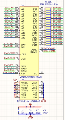

carstengroen
Senior Contributor II
Björn,
I use this in my designs:
This is my board.c file:

    IOCON_PinMuxSet(IOCON, 2U, 0U, IOCON_PIO_FUNC2 | IOCON_PIO_MODE_PULLDOWN | IOCON_PIO_INV_DI | IOCON_PIO_DIGITAL_EN | IOCON_PIO_INPFILT_OFF | IOCON_PIO_SLEW_STANDARD | IOCON_PIO_OPENDRAIN_DI);
	// FLASH-SO (FC0-MISO)
    IOCON_PinMuxSet(IOCON, 2U, 1U, IOCON_PIO_FUNC2 | IOCON_PIO_MODE_PULLDOWN | IOCON_PIO_INV_DI | IOCON_PIO_DIGITAL_EN | IOCON_PIO_INPFILT_OFF | IOCON_PIO_SLEW_STANDARD | IOCON_PIO_OPENDRAIN_DI);
	// FLASH-SCK (FC0-SCK)
    IOCON_PinMuxSet(IOCON, 0U, 28U, IOCON_PIO_FUNC1 | IOCON_PIO_MODE_PULLDOWN | IOCON_PIO_INV_DI | IOCON_PIO_DIGITAL_EN | IOCON_PIO_INPFILT_OFF | IOCON_PIO_SLEW_STANDARD | IOCON_PIO_OPENDRAIN_DI);
_WDWORD(0x40000208, 0x00000080);         // SYSCON->AHBCLKCTRL2 = Bit 7 (EMC)=1

Thanks @carstengroen. I have gone through the info but so far not found the cause of my issue.
/Björn
