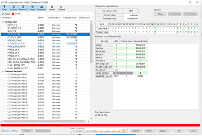

Following AN12283 it is possible for a user to delete the firmware and this is not acceptable for my use. So I try to use AN13037 but I’ve got the following issue:
1) Using MCUXpresso Secure Provisioning, I can't modify CC_SOCU_PIN/DFLT (in CMPA and/or CFPA) because I've got this error:" Ths CMPA.CC_SOCU_PIN[0:9] must be either all 0 or all1!"
I put the same value for both SOCU_PIN and SOCU_DFLT (0xFFBF0040). Even If I put all bit in disable State, I've got this error => How can i use this tool to disable all expect ISP mode?
