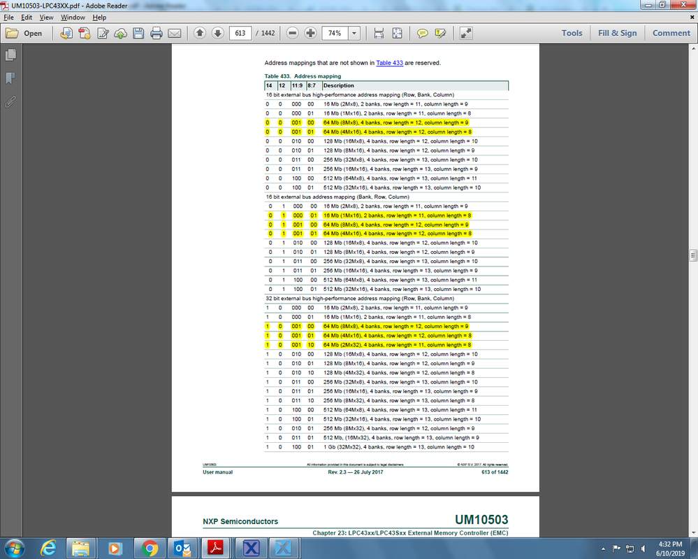

There is one more observation reagrding the memory that we are using.
You can see highlighted part where is it mentioned the memory configuration. But similar memory configuration is not available in the user manual of LPC43XX.
is there a probelma related to this? Since the same behaviour is ther there after doing following method.

Q2) The highlight configuration is suited for the AS4C4M16SA.
