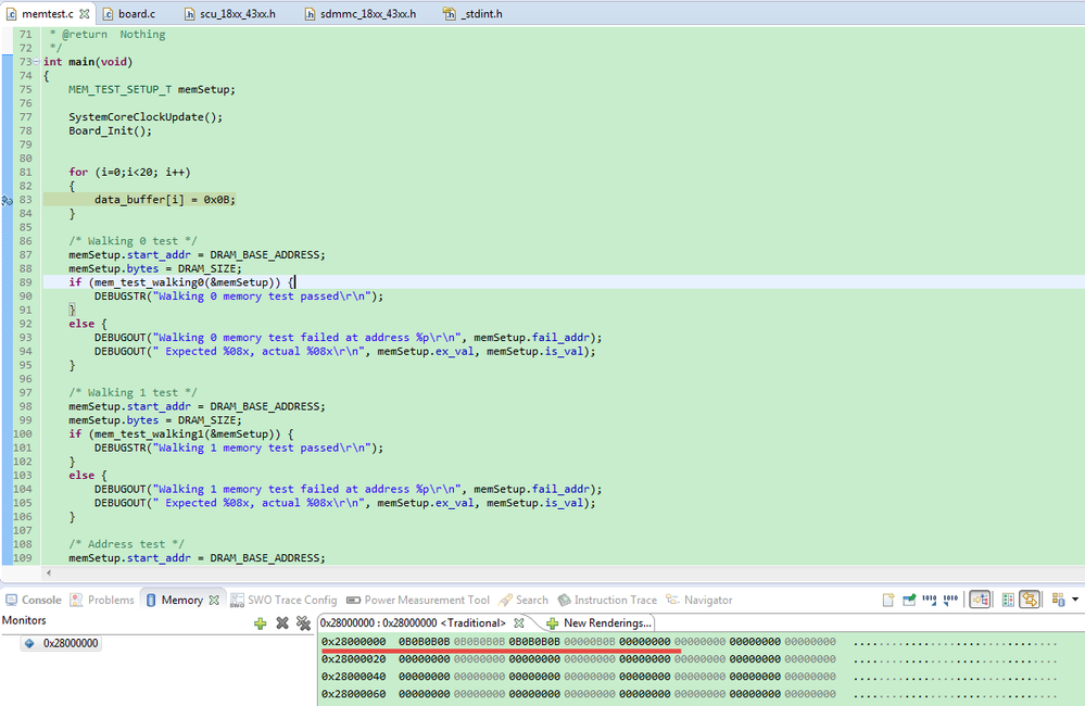

I've done some testing with your code in the periph_memtest demo, however, in debug, I don't encounter the similar phenomenon you mentioned before,
My board is MCB4357, IDE: LPCXpresso v8.2.2.
(在“我的视频”中查看)
Fig 1
Fig 2
TIC

I check with my code for SDRAM and while running the code I found the following behaviour,
While loading the code and running the code it is observed that it is storing the data on multiple location.When I am running the code mentioned below with stepwise execution,
__SECTION(data,RAM8) uint8_t data_buffer[1024];
Length = DRAM_SIZE;
for (i=0;i<Length; i++)
data_buffer[i] = 0x0A;
I just run for i=0 and data_buffer[i] = 0x0A;
and then checked the memory. So follwing is the observation.
Instead of storing the data in only data_buffer[0] = 0x0A; sinze i=0 it is also storing the same value 0x0a in other locations as well refer the screen shot for observation.
Also one more observation is when I am stopping the execution stepwise and checking the data in expression and memory as shown below then again while proceeding for the next step then it gives below error
But if without the checking the debug value and running step by step  the it works but it is storing the value in all other locations as well as i have mentione above.

However, it doesn't matter actually. And maybe you can tell me if I miss something.
About the new testing, I've migrated to the memtest demo to test, and it works well on the MCB4357 board.
