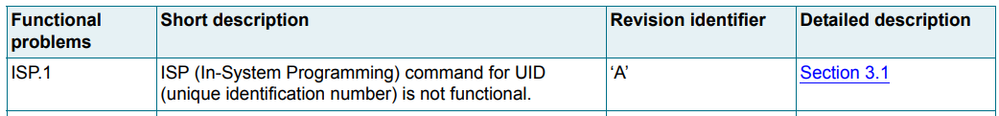

I am trying to retrieve the UUID from my LPC54113 using the IAP commands. I followed the instructions on the chip manual.
The problem is that the return value is always 0000FFFF 00000000 00000000 00000000 , and I'am pretty sure that this isn't right. This seems to occur only whith the read UUID command, as other commands (i.e Read Part Identification) return correct values.
The code I use for reading the UUID is:

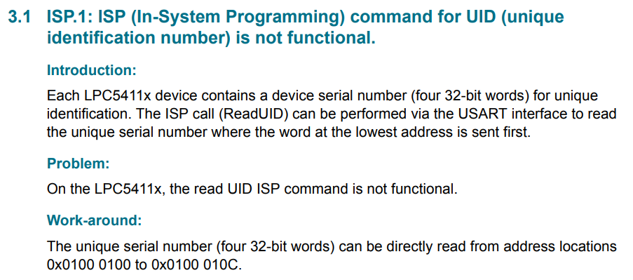

Hi Eduardo Carletti,
for the opportunity to serve you.
There's a bug in the LPC5411x series MCU (as below figures present), and the unique serial number (four 32-bit words) can be directly read from address locations 0x0100 0100 to 0x0100 010C.

eduardocarletti
Hi jeremyzhou, this worked. Should I be worried about this address changing on newer chips? Do you know if are there newer revisions of the MCU being sold or under development?

jeremyzhou
Thanks for your reply.
1) Should I be worried about this address changing on newer chips?
-- No.
2) Do you know if are there newer revisions of the MCU being sold or under development?
-- No.
Hope this is clear.
