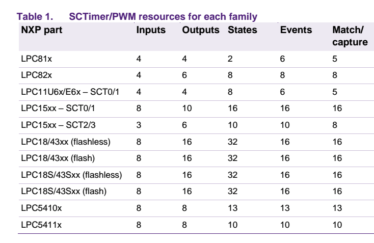

Hello All,
I have a project that controls an AC fan motor via a triac. It senses the zero crossing & then after a delay triggers the triac to supply power to the ac motor. The speed of the fan is determined by the delay (which changes depending on user input) in switching on the triac. It is similar to attached the circuit.
I had been using interrupts & an LPC1768 for this project but am now switching to an '812. After investing it looks like the SCTimer/PWM is a suitable, but complicated in setup & control. Could anyone with experience tell me should I stick with an interrupt driven setup or is the SCTimer/PWM suitable? Once it's setup correctly it seems like it offloads alot of potential overhead.

leo838
Thanks for the suggestion but I need accurate timing from an input going low & so I need to start the counter from zero from that event.

leo838
Jeremy,
Thanks for the reply.
Yes, your correct, the reason I was getting the 5ms delay was the the counter reaching all ones. My post previous to this outlines the reason the counter was not cleared.
I've attached the last version of my project for reference. The quickest I could achieve the stop, clear & restart scheme of the counter was approx 1ms, if you can see any quicker way I be grateful if you could share!

leo838
It looks like I've found the issue.
I was attempting to stop the counter & trigger an interrupt routine based on the same event. It appears that the counter was still running when the ISR attempted to clear it, hence it failed. Moving the call to the ISR into the following state solved the issue.
However based on the new code the minimum delay I was able to achieve using the stop, clear & restart scheme of the counter was approx 1ms, unsuitable for my application. I cannot see a way to achieve this any quicker. Also occasionally the clearing of the counter was missed & a long delay occurred.
I can definitely see the usefulness of the SCT but unfortunately it seems inappropriate for my application.

In state 1 I’m using the L counter to achieve a delay. The other two states using input edge transitions as events. After using the L counter in state 1 should I stop the counter?
21,232件の閲覧回数
jeremyzhou
Hi ,
Thanks for your reply.
According to the description of your scheme, I don't think it should stop the counter after using the L counter in state 1.
TIC
21,232件の閲覧回数
leo838
Jeremy,
Thanks for the reply. I've spent hours looking at the code & trying to debug but without any success. I've verified that it increments to state 2 & gets stuck there, the event (number 3) in state 2 is never triggered. I've tried numerous ways to trigger & verified the inputs show a level change but no action occurs in this event.
I had thought I'd discovered the reason as a possible bug in the file fsl_sctimer.c. At line 516 the following code appears:
  /* Enable the event in the current state */
    base->EVENT[s_currentEvent].STATE = (1U << s_currentState);
Once s_currentState increases beyond 2 this fails to set anything (only bit 0 & 1 can be set) but this has no impact on my code. Perhaps I'm missing something.
I can only suspect another possible bug or I've damaged my board (an Xpresso board) during debugging. I've attached the project, if you had a moment to see if it runs on a similar board I'd be much appreciated.
21,231件の閲覧回数
leo838
Well the penny finally dropped! The part I'm using (812) only has 2 states for it's SCT, others have more. Interestingly the manual mentions numerous times the max possible number of events but not states. The SDK software checks for exceedance in events but not states. I found the table below in the SCT cookbook, included for reference by others.
As an aside is it possible for the L & H counter to use the same input & output or must they be separate?
21,231件の閲覧回数
